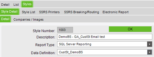

Actually I notice that the Demo Report Style in the old client Report Style Maintenance has the default CustST as the Data Definition which should have been my CustST_Demo which I cannot now change

I am using a combination of both, using the full client with Classic Report Style to do the Break/Change but the RDD only in the web client.

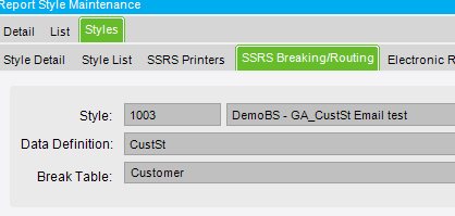

So here is where it gets weird, in the Classic Report Style I can change the Data Definition using the drop-down under the Style Detail tab but when I click the SSRS Break/Routing tab I cannot change it.
The Demo Style shows CustSt under the Break/Routing despite showing a custom DD in the Style Detail, and it cannot be changed in here.
Wow I have never noticed that and have never had a need to change it… Not sure of the ramifications if different… But looking at the field help the values are stored in two different tables.
EDIT
My mistake yes you can delete the breaking and routing… In classic you need to click on any of the fields in the in the SSRS Routing and Breaking and then click on the X in the toolbar. That will allow you to delete it and readd it with the correct data def.

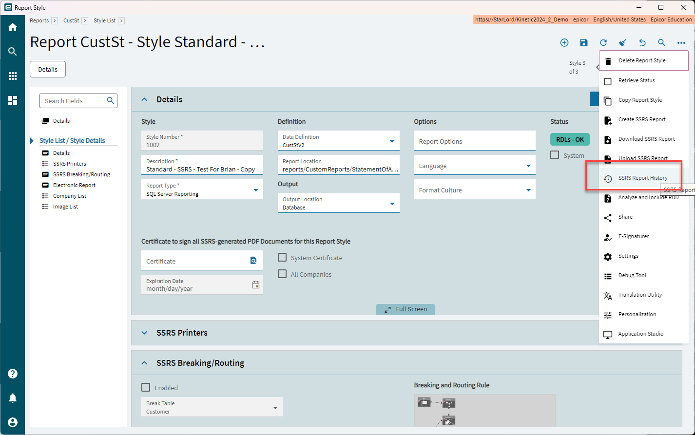

Have not noticed the SSRS Report history in the overflow menu. That is a nice value add…
Does not look like you can actually add a routing and breaking in Kinetic.
+ sign is disabled.

Deleted the Demo Break and recreated, now showing the correct DD, thanks again Simon.

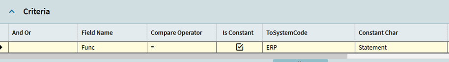

Another interesting discovery is that the Criteria needs to have ToSystemCode = “ERP” otherwise all you get is a print preview and no email.
If you create it and forget to type ERP in there then the only way to fix is to delete the criteria and re-create.
