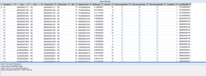

This is great, I have applied it in the Query and it comes out almost all the information of the BOM that has several levels, but the amount that appears is that of the child, the amount of the parent does not appear and I require it to get the cost of the entire BOM .

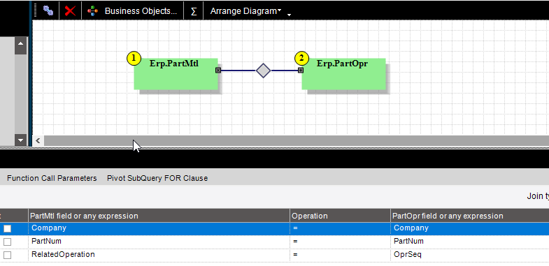

I know this is an older post but hoping you could maybe point me in the right direction. I am trying to add the operation description instead of just the related operation number. When I add partopr along with the operation description it duplicates the lines multiple times instead of just showing the operation description based on the partmtl related operation.
Something is wrong with your join then. It’s getting multiple matches. Maybe the revision isn’t matching?
I would make a test query and pick an example that’s giving you problems and see which table is getting you extra rows.
A quick and dirty way to see is to add the sysrow ID from each table and you can see which ones are duplicate rows, and which are unique.
I just gave it a quick go, seemed to work OK
You’ll need to add a revision to that join, if you have multiple revisions, you’re going to get duplicates.
So I got it to work. Part of the problem was related to all revisions showing instead of just the approved Rev and the second less annoying part is that it will duplicate the material based on how many operations are typed to the parent part but that is manageable, Thanks for pointing me in a good direction.

DMS_GetBomFull.baq (65.5 KB)
