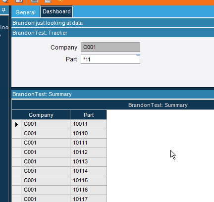

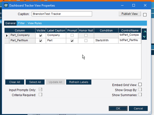

You can set the tracker to starts with, then use wildcards in the actual value.
