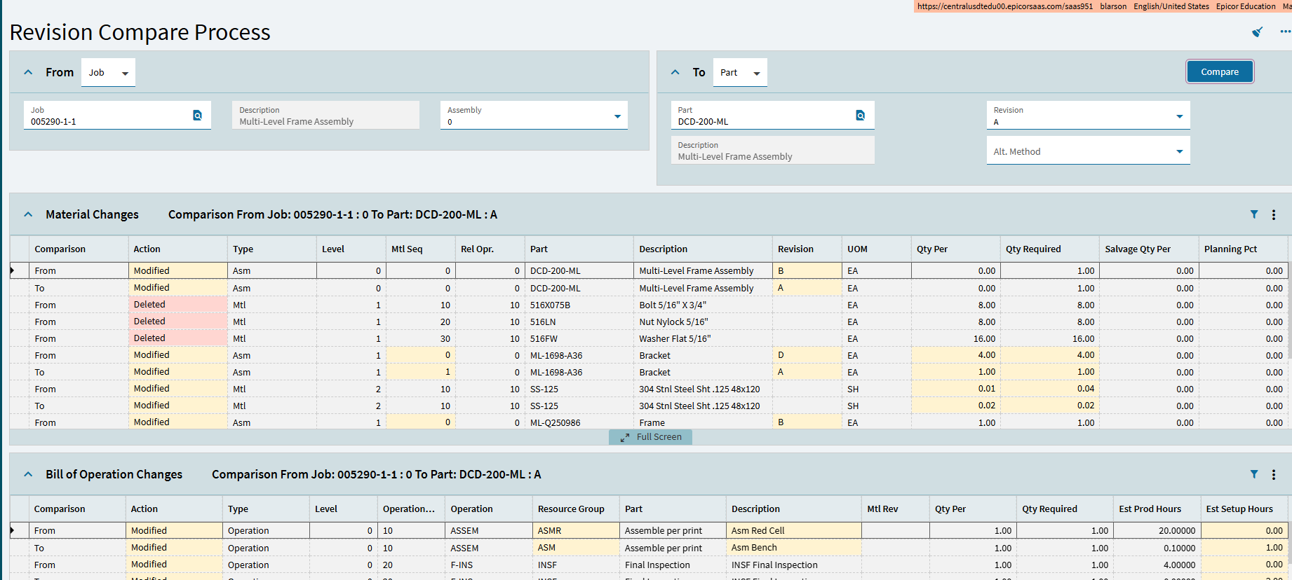

There’s a “Revision Compare” menu which, I thought just compared one part revision to another. But it looks like it WILL compare a Part Revision to a Job…
Could be a promising start, I just need to try to figure out how it is presenting the results of the comparison.

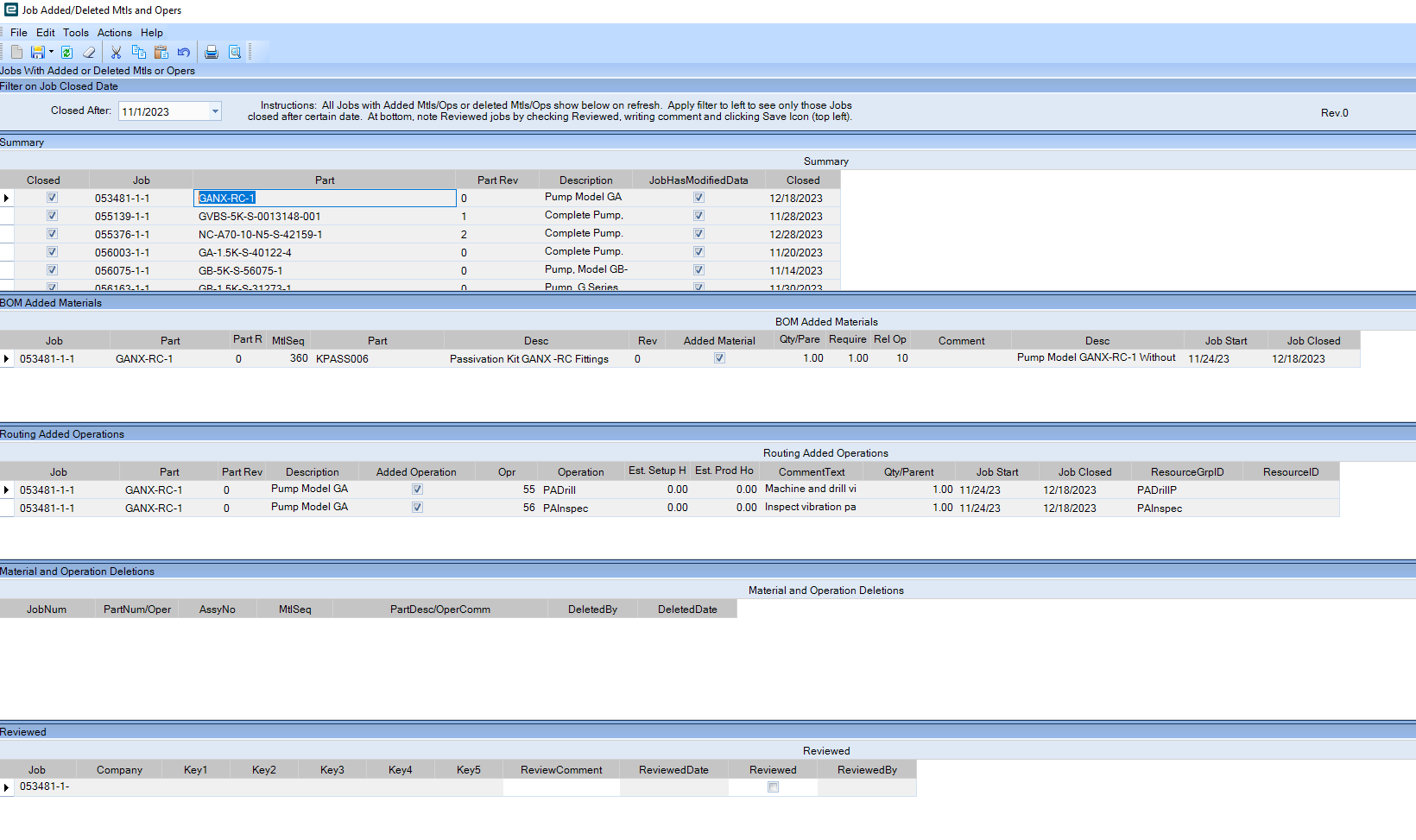

We created a solution for this but it hasn’t gotten great traction for use, so I’m not completely sure that it hits the mark. I suspect that the person who requested isn’t the person who should be managing it, so you know how that goes. Anyway, it might be useful for you to see our solution to get ideas. (We found the rev compare too noisy.) In summary:
Upon add material or add operation to a Job, a BPM checks whether there’s an approved method and if so, it automatically checks added operation or added material upon the addition. (note users can uncheck if seems erroneous to mark as added) Another BPM saves any deleted operation or material from a job that has an approved method to UD25.
After that, there’s the Job Added Matls or Opers TUSA dashboard that provides the interface for reviewing the additions and deletions for closed jobs. It’s under engineering.
Here is a screenshot of the dashboard along with instructions and ability to checkoff review.

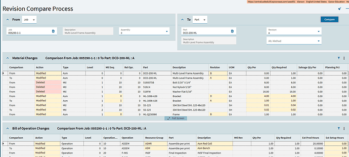

Have you looked at Revision Compare Process - standard functionality?
You can put in a quote, part, job, or engineering group and compare to another.
Click the compare button to see what is different.
Hi @LarsonSolutions. Yeah, I did mention that dashboard above in this thread. It has come a long way! It was very difficult to decipher initially but they made some improvements in 2024.1 or 2024.2 that makes it a little more clear.
I guess I can’t say I use it personally (to many other things to worry about)… but I did introduce it to our engineering team, so, hopefully they’ve explored it!
One issue is that we saw with the Revision Compare Process is that when compaing old revisions the material revisions are not correct for us. The child revision shows current child revisions, vs. the revision of the child when the parent was at the selected revision.
We did have to create a custom compare tool to “fix” that.
