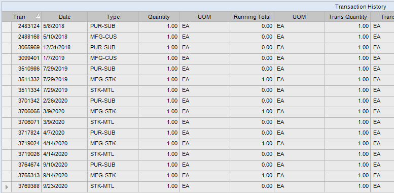

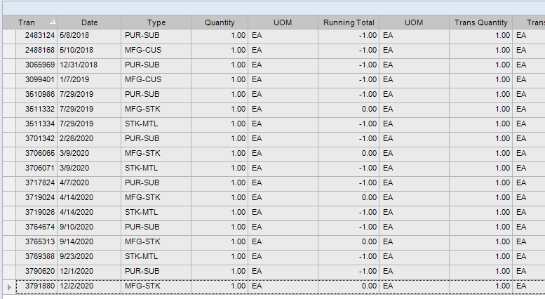

Well, I got nuthin’ now. I’m going to repost your original Production image, for easier comparing side by side. That is definitely odd.
Yeah, I don’t even know why. Found that a few months ago. Bigger fish to fry and I just filed it away in the memory banks.

That looks like a “back-dated” transaction though. If you queried the system on 7/23, that 7/17 transaction wouldn’t be there and you’d observe a discrepancy between system and physical?
Like, in that case, I’m perfectly fine with the running total not in sync kind of thing.
Right, that’s what I said. That’s the problem. You get quantity out of thin air without the GL activity for it.
Well, without the GL activity at that moment - at the same time as the inventory is created out of thin air. I think your argument is that the GL activity had to have happened already and this gets the QOH in line with that.

And I was unclear in those posts. The tran numbered 152806 should have bee the highlighted one (its the one that was out of order).
But either way, it shows that sorting by Tran Num could make the Running Balance column irrelevant.

The Part Tran History form does not use the PartBin records at all. It uses PartTran records from the earliest date, and add /subtracts each later record (but with the TranDate as the order, not the TranNum).
The Running balance column won’t be affected by neither the “Starting Date:” on the Tran History form, nor the QOH in the PartBin.
