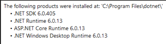

I am having the same issue. I have a very simple UBAQ. The UBAQ will work on another workstation with no errors, but on my workstation I get a long list of errors. Just like the above posts, I have similar error messages:
Second error message for UBAQ.docx (24.1 KB)

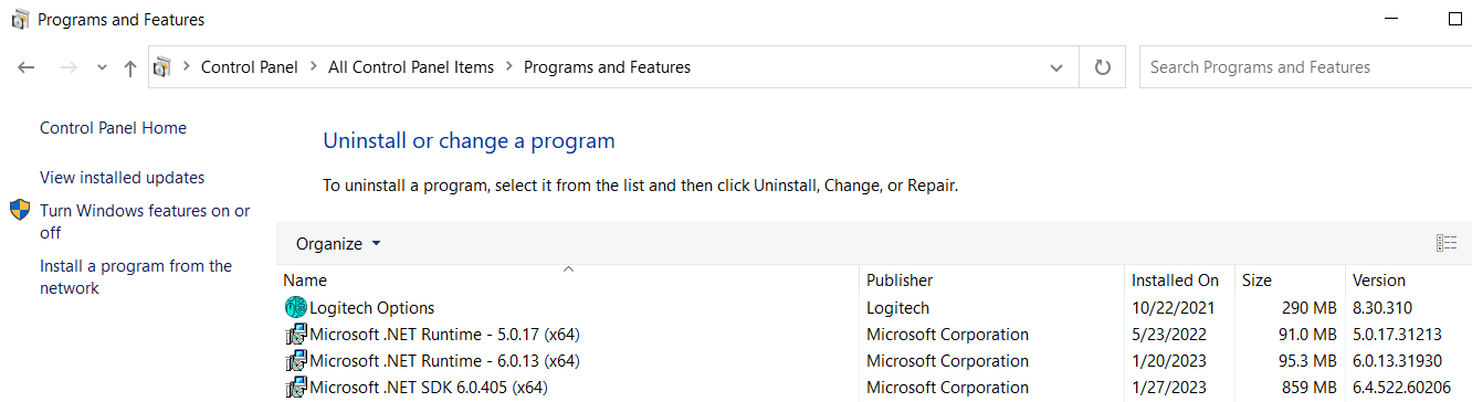

Epicor has told me almost the exact same advise as Raul Dominguez received in December 2022. I have copied the Epicor client from the no error workstation and installed it on my computer. No solution. I have installed .NET SDK 6.0.405. No solution. I have not been able to reinstall .NET 4.8. The installation was blocked. Is it safe to remove .NET 4.8 and then re-install? .NET 4.8 is also not showing up as an un-install option.

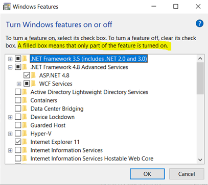

I also see that only part of the .NET Framework 4.8 Advanced Services is turned on but I know of no way to alter this.
Any recommendations?

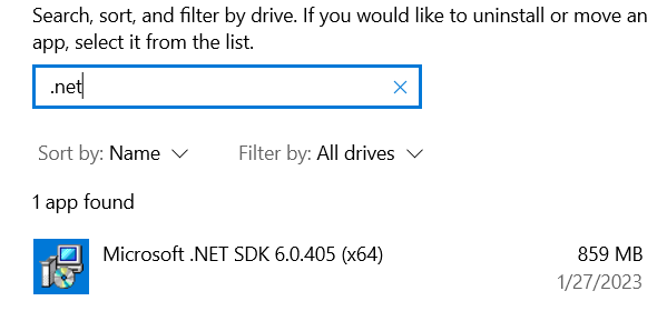

I uninstalled Epicor, Deleted the Epicor folder, Deleted the Epicor folder in Program Data, a search of the Program Files and Program Files (x86) yielded no results for Epicor. I uninstalled the .NET SDK. Rebooted, installed .NET SDK:
Rebooted again. Then installed the Epicor Smart Client but still getting the errors.

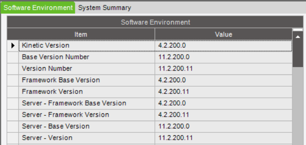

My problem keeps getting worse. Epicor Pilot had an update over the weekend. We are a multi-tenant customer and receive all updates.
Now I am not able to get into the Part, Part Tracker, and Part Transaction History Tracker. Each screen errors out with the following message:
System Information
AppServer Connection: https://ausmtsPilot102.epicorsaas.com/SaaS201Pilot
Form Name: ShellMenuForm
Customization Name:
Menu ID:
Software Version: 4.2.200.11
