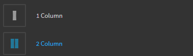

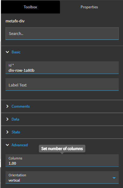

One thing that some of you might find quite useful—which I forgot to mention earlier—is this:
Getting the screen layout how you want it in Kinetic can be quite “challenging” at times. I’ve started dropping in the ‘2 Column’ toolbox item, even if I’m only planning to use a single column. The name ‘2 Column’ is a bit misleading because you can actually set it to any number of columns—including just 1.
This gives you much greater flexibility when you’re trying to get things looking right on screen.
Might be really obvious in hindsight, but I went quite a while dropping in multiple ‘2 Column’ controls if I wanted 4 columns, for example :laughing: Hopefully this saves at least one other person from going down that rabbit hole!
