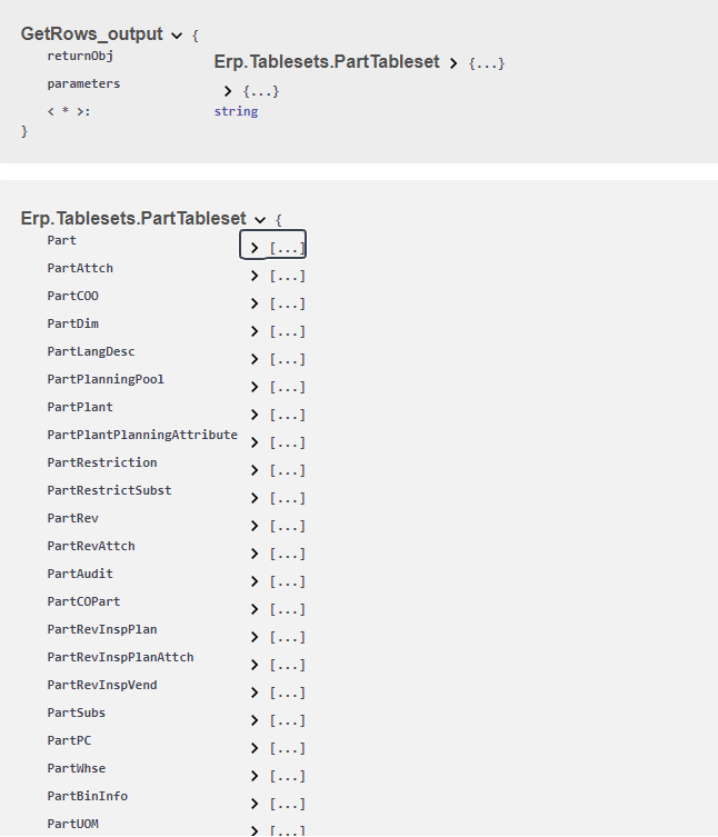

No where clause on GetRows would return all? I seriously don’t know the answer to this.
Again, don’t care about the upload at this time. Running a bunch of DMTs is my plan for now.
That’s why a csv. You can open it in Excel.
I stand corrected. I was thinking of GetList. GetRows gets everything:
One thing to keep in mind is that the result of GetRows may not map 1:1 with your DMT template. You may have to rename some columns
