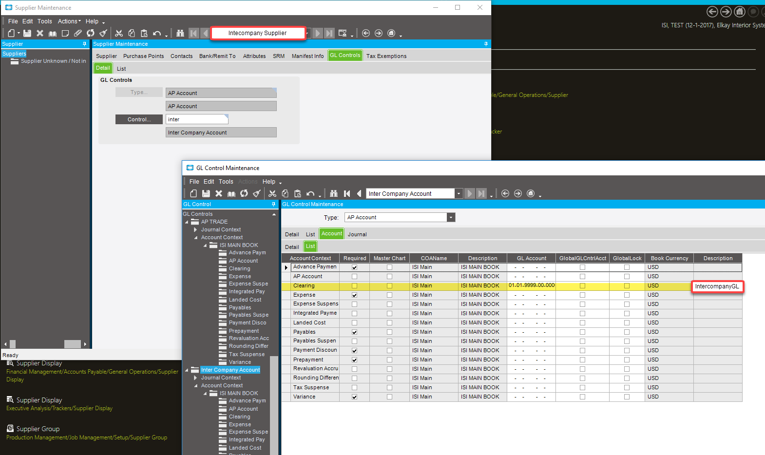

As far as getting the GLs set, then if I set an AP Account GL Control on the specific suppliers, create the new control and set the clearing account to be the “intercompany” GL, then all should be well, right?
