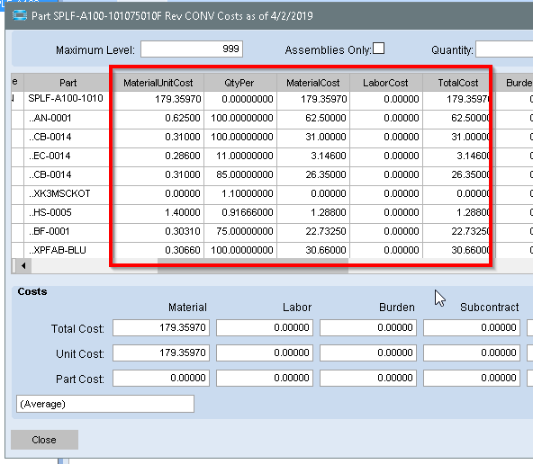

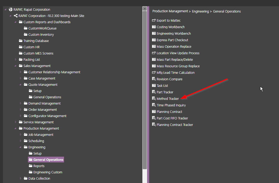

I agree, something is off. Its the WHERE! LOL!!! I am working on it with my engineering lady now. The granular costs form Method Tracker shows the difference is in our ink and labor. Not sure why the labor, but I get the ink. Hopefully we can finally find it.
What screen and sheet is the left image from? You say “Method Tracker”, but I see nothing like that in mine (10.1.400.23).
It is a stock screen.
Okay… What sheet?

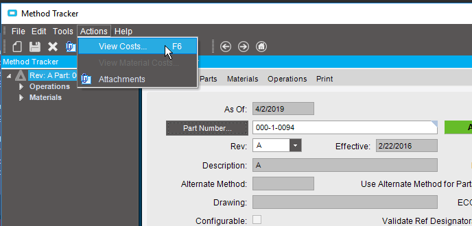

EDIT:
Never mind … I now see the “View Costs” under actions
Actions view cost
So looping back around… The OP’s issue is that the cost from the method, is not what is used when the STD Cost Roll-up was performed?
Furthermore, two assemblies (one Red, one another color), use the same parts and qtys - save for the RED part(which has the same unit cost as the non red part), but their costs are different.
OP should re-arange the columns in the Method Tracker’s View Cost, like such
And compare the two parts
No, the method is what’s being used, but the costing from the method from 2 “exactly similar” parts, doesn’t come back with exactly the same cost. (the labor is $0.00031 off.)
Actually, over all, including labor, is about .02542 off. I’d expect the labor to be the same but its off by the .00031 you mentioned. Material I think i have a lead on. Waiting for my engineer to come and confirm before I speak.
