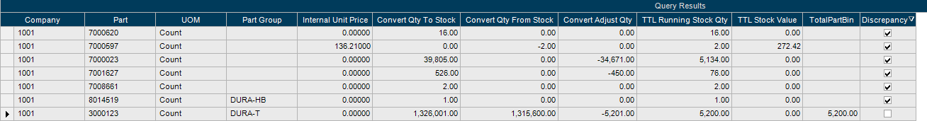

So after running this, I tried @A.Baeisa 's query. I added PartBin to it and totaled that column and then added a bool to compare what PartBin had and what the query shows after adding up PartTran.
I still have 6 that don’t match. Any ideas?

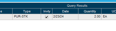

The other two I’m really confused on. 7008861 has a single part tran record which is a PUR-STK for 2 so it should be in inventory, but isn’t

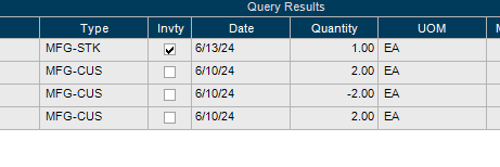

The other one, 8014519 has 4 transactions, 1 MFG-STK for 1 which is what you are showing then 2 MFG-CUS: 2, 2, -2
By your math and mine, this should also add up to the 1 you are showing on your BAQ.

8014519
Your BAQ shows 1 in inventory (which looks like it should be correct, partbin shows 0 in inventory)
7008661 has 1 transaction:
Your BAQ shows as 2 (which I would say has to be correct) and PartBin shows 0

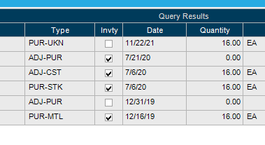

7000620 your BAQ shows 16 my partbin shows 0
I would think the 16 is correct, but PartBin shows 0
Makes me really think I have something wrong in my system that the refresh isn’t catching but maybe I’m missing something.
you may check what trigger these transactions, i.e. ADJ-PUR is strange do you know what trigger it ? anyway on the last table only PUR-STK is effecting inventory quantity, the rest is not, however it might effect the inventory money value/cost as i explained but not the quantity, also PUR-UKN means the PO was for Non-Stock Part, so how come the part became Stock Part ? something is not correct on the process of using Epicor PO Vs Part Setup
I’ll look into ADJ-PUR.
I would agree that only PUR-STK should be affecting inventory, but then how is my PartBin record showing 0? It should be showing 16. I realize the rest shouldn’t but without them, how are we adding 16 to stock and coming up with a quantity of 0?
