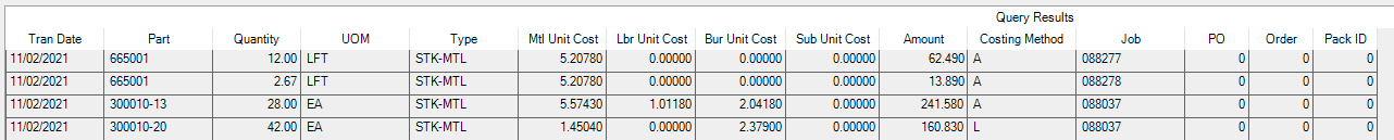

I’m much better at DMT and UD tables than I am SQL. I create a BAQ in E9 for the PartTran table just going back for 1 year to start. I’ve settled on 15 columns That have what I think anyone will want. I’ve added a screenshot:
What I’d like to do is load this data into a UD table and create a dashboard to search for a part number and possible a transaction type then view the corresponding data.
