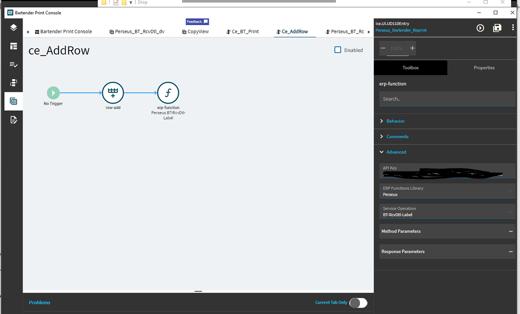

Know this an old thread , but helpful info for those looking to do this, found a way to send Selected Grid Row Field data to function with the following:
- Use the Copy View instructions posted under write up titled “How To: Kinetic - Working with Grid Selectors”, in the associated ce_ADDRow iterate event, after the row-add component, added a ERP-Function component which passed the current CopyView row field to my function as a method parameter. It’s the little things … Cheers

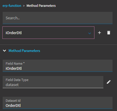

Using ERP-FUNCTION in the Kinetic client, I was able to pass a dataset (view) from the Kinetic client to a function. In the ERP-FUNCTION, set the Method Parameter ‘Field Data Type’ to dataset, and set ‘Dataset Id’ to the view name, such as UD25View. In the server side function, set the Request Parameter type to System.Data.DataSet. It works.

Actually, using this approach my dataview is not getting passed, this is what my setup looks like:
Function parameter:
Network request:
(empty dataview, my order has 2 lines)
thanks

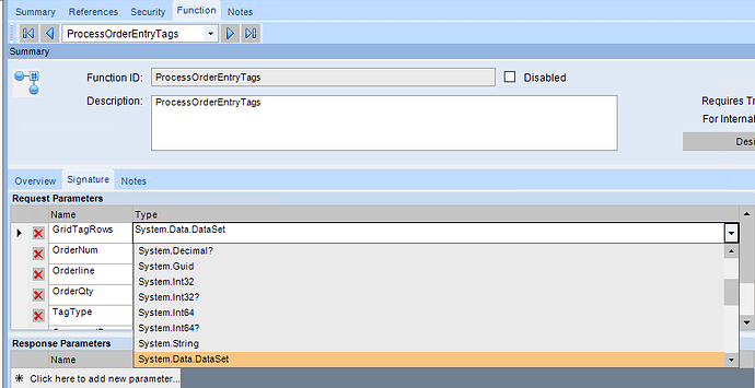

Hi Scott,
My function input parameter looks like this:
Name: GridTagRows Type: System.Data.DataSet
Inside the C# function code, I was able to get to the column as follows:
var tables = GridTagRows.Tables; // tablesSystem.Data.DataTableCollection
foreach (DataTable table in GridTagRows.Tables)
foreach (DataRow dr in table.Rows)
dumpGrid = dumpGrid + dr[“Character01”].ToString();
Hope this helps.
Mike

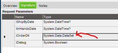

ok, yes, that’s similiar to what I am doing,
this is my function signature:

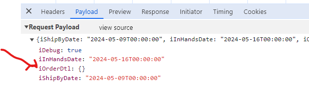

But when I pass the OrderDtl view, the network request shows it’s empty (and my function trace tells me it;s null) ![]()
and when I use Ctrl-Alt-V with debug tools (F12) OrderDtl is not empty and has 2 rows
Is your “GridTagRows” really a dataview ?

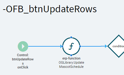

User selects multiple rows to apply the same update, for example specify a date and then apply that to a date field on multiple rows in the grid. For this I have a button with an event:

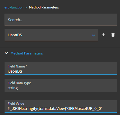

for the function one of the parameters is ‘iJsonDS’
(input, JSON, dataset represented by a json string)
the sneaky part (found somewhere else on the forum) is the field value:
#_JSON.stringify(trans.dataView('OFBMascotUP_0_0').viewData)_#
the only part you would need to change is the view name, mine is “OFBMascotUP_0_0”

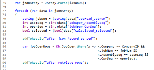

the code that handles iJsonDS in the function looks like this:
I’m parsing out 3 fields that I used in a DB table where clause lookup
(jobNum, assmSeq, oprSeq)
and one field that I use to determine if the row is one of them selected to be updated
(selected)
update selected rows then use Db.SaveChanges to apply the update to the database

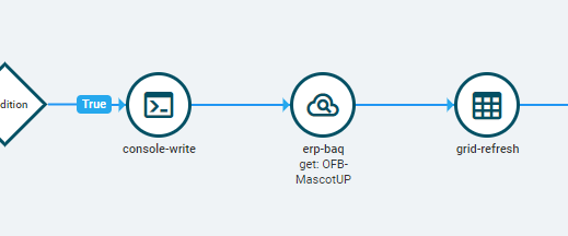

then after the function completes I refresh the grid in the event with:
Hope that helps

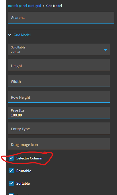

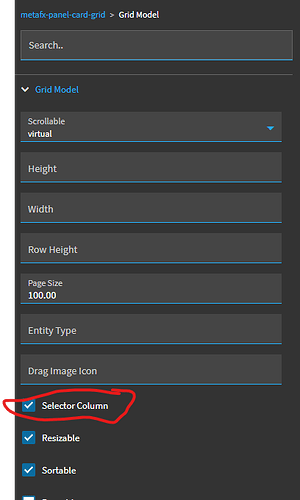

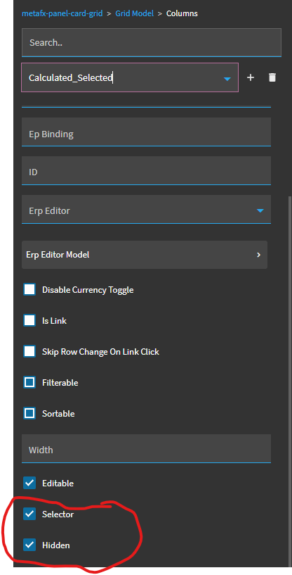

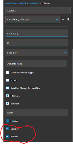

I have a calculated field in my BAQ that is just a boolean with a default value of false.
Then in properties for the grid, data/grid model/columns set that column to be the “Selector”
you also need to turn on “Selector Column” in data/grid model
The “Selector” property on the column ties the field to be the selector column,
If you don’t also mark it as hidden you will have two checkboxes to select rows
then when the Json dataset gets passed to the function you can parse out the value for the name of your calculated field, in my case “Calculated_Selected”
Hope that helps

I totally understand this but that datatype is not showing up. Is it that the modern/classic view of Epicor Functions Maintenance does not have it or is there something that has to be changed to allow a signature paramater of that type?
I am only getting - Date, String, Bool etc.
This would be a game changer. I can put a lot of our old UI code into functions and use it with little modification.
I’ve gotten functions to work - they arent new. But passing datasets is.
You need to scroll down the list.
I was hoping to reply before I was outted. I figured it out and hit my forehead. Thank you all!

I pass the view but there is nothing in it (according to the function), which makes no sense. I can see the data on screen.
I figured it out by throwing an exception showing the count of the number of tables which was 0.

I am using the CLASSIC Epicor screen when I use the Epicor Functions form (windows form, not browser).
The drop down for ‘Type’ has System.Data.DataSet. I am on version 2023.2.
