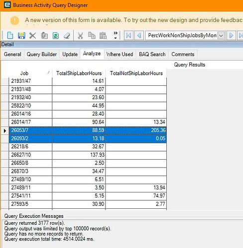

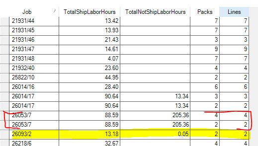

I added in counts for the ship packs and lines. I think the issue is when there is more than one pack and/or line. Here you can see a section of my data. The yellow highlight is one correct job showing the right hours on the ship side and the right hours on the nonship side. In the rows above it you can see the job from my first example. 88.59 is the correct hours spent on the job in the same month that it shipped. However, 205.36 hours is double the number of hours spent outside of the shipping month.
I was hoping I could count up the packs and lines and those numbers would make sense so that I could just do a divide by #lines and get the right amount. But there is clearly something else going on here.
In this case (26053/7) There were two shipment packs, one had 4 lines and one had 2 lines. I think that I need to divide by the number of packs, but I can’t seem to return that value correctly. When I remove the packs and lines columns, then I only get one row for each job, and the pack count stays stuck at 1.

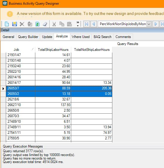

Capture34565g

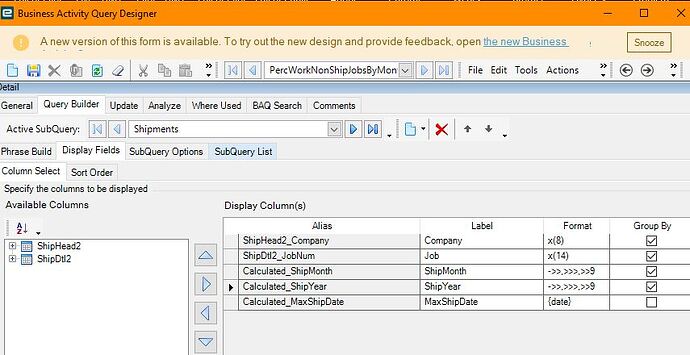

So, the Shipments CTE, group on Job and bring in the shipdate in an expression to take the MAX ship date. That should get rid of any duplicates.
I did this. Still gives the same data. Doubling that one value.

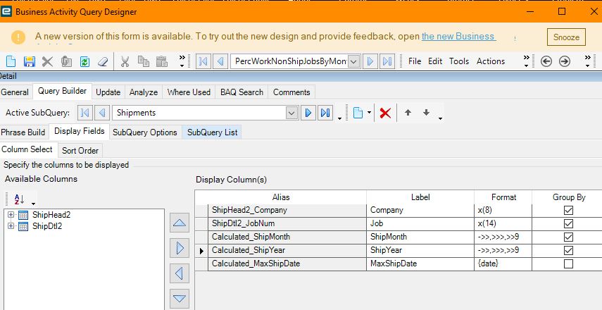

You need to take out the Month and Year because you are still creating rows for each shipment. Remove those, add in another CTE that takes in the first CTE and make expressions for the Month and Year from that.
do i relink the inner CTEs to the unique shipment CTE or leave them on the original shipments cte?
You now need to bring in the new shipment CTE and delete the old one.
This is what I have. I think it is working perfectly. I will be checking the results thoroughly before I release it to the managers. Thank you for your help. I can’t say I get CTEs anymore now… but I do see the potential!
