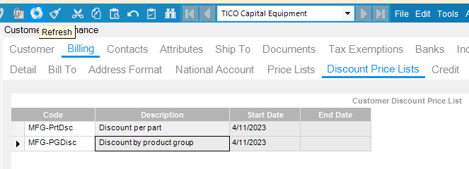

  3. Then assign discount lists in a hierarchy
    a. This goes in Customer Maintenance > Billing > Discount Price Lists

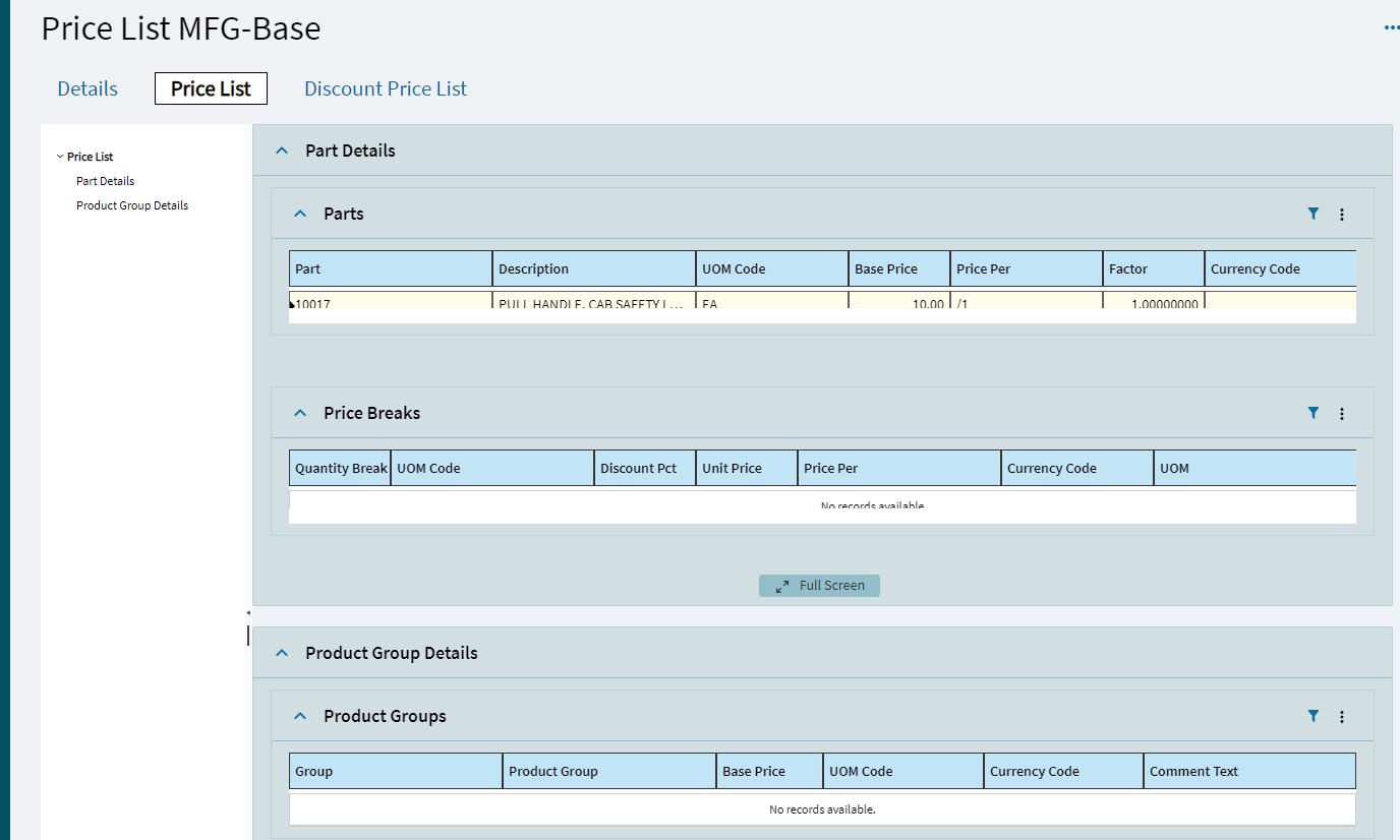

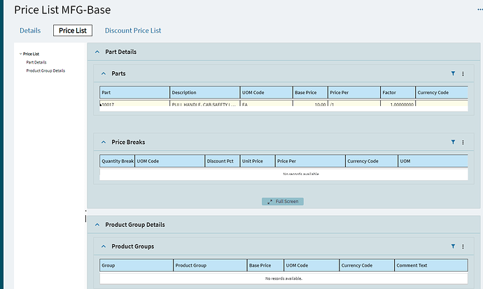

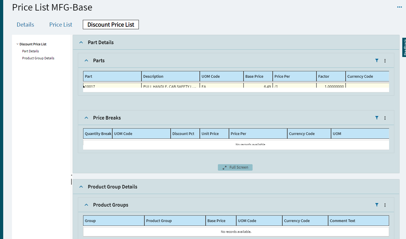

I made part 10017 have
  • Base price list (“unit” type) = $10.00 each
  • Discount PART list = $6.49 each
  • Discount PRODUCT GROUP list = 25% off
I assigned the base list as the customer’s “price list” and the others as their “discount price lists.”

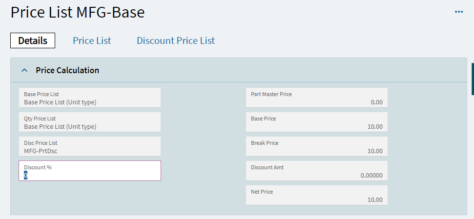

I used Price List Inquiry and entered the following:
And it came up with $10 each, not 6.49 as I expected and wanted:
But when I look at its logic, it’s right: $10 base…
…And $6.49 discount price (and no prod grp discount):
So why won’t it use the $6.49?
