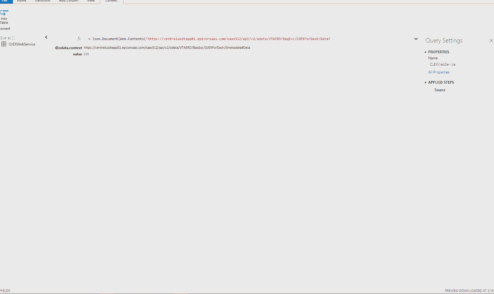

My power query editor looks like this:
Source:
= Json.Document(Web.Contents("https://centralusdtapp01.epicorsaas.com/saas512/api/v2/odata/VTAERO/BaqSvc/OJEXForDash/Data?api-key=blahblahmyAPIblahblah"))
Navigation
let
    Source = Json.Document(Web.Contents("https://centralusdtapp01.epicorsaas.com/saas512/api/v2/odata/VTAERO/BaqSvc/OJEXForDash/Data?api-key=blahblahmyAPIkeyblahblah")),
    value = Source[value],
    value1 = value{0}
in
    value1

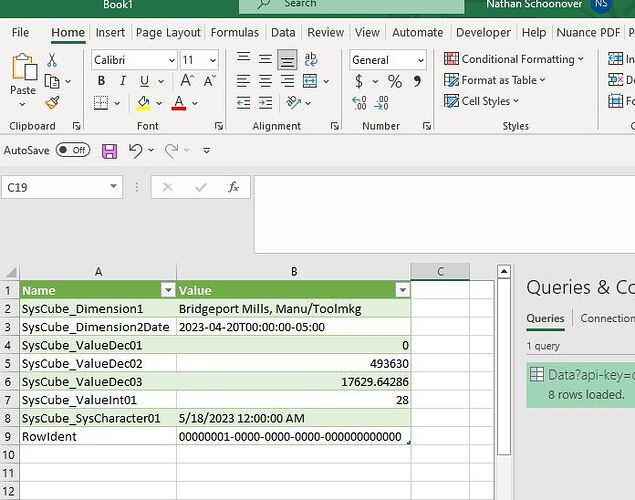

When I run this, I get only one record of data back. Do I need to include something else to show all the rows of data?
Here I show only the one row of data returned. If I change the value[0] to another index, then it returns that record instead.

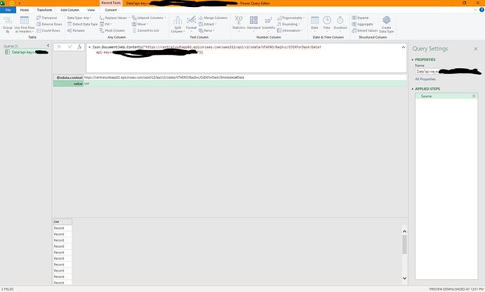

If I don’t change anything in the power query editor, this is the base source result:

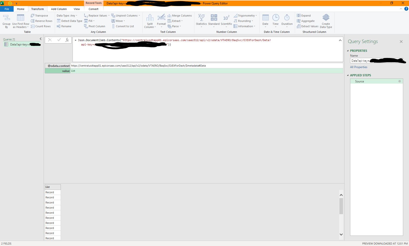

If I click the “list” in my source value field, then I can get a list of the 40 records in my BAQ. Then I can get the data for a single record by clicking on the value in the list. Then it returns just one value like this:
I want to have all my data in rows, and the columns should contain the values. Just like my BAQ returns. Why can I only show one record at a time?
I can help you with that, you need to expand the results to a table.
It’s hard to explain honestly, but in the second step I think you need to expand the value of the second row of your data, not the API response header row. And then keep expanding and keep expanding till you see a table haha

I dont see how to expand it to a table and keep it that way. I can only seem to show one record with data at a time.

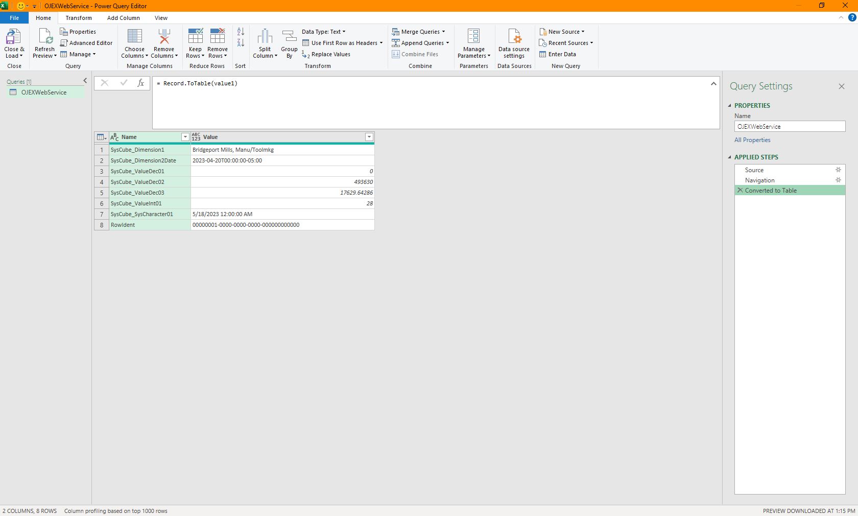

Alright! Now we are getting somewhere! Thank you @utaylor for the offline help.
As a summary, I was stuck in power query editor with only a basic return of my BAQ data. Utah showed me these steps to get all the data to show.
First Click “List” under your first record. Then click To Table. Then click the little stupid two arrow thing at the top of a column (seriously WTH even is this?) That was the trick. Everything else was just niceties for display.
As Utah warned me, the refresh of this data may be an issue. I will test that with some other users later.
