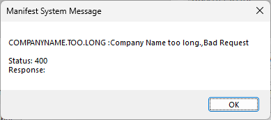

There are a number of properties in the Fedex OpenAPI specification where there is a maximum length listed in the description but have no maxLength property defined. Here’s one example of this:
"companyName": {
  "type": "string",
  "description": "The shipper's company name. Max length is 35.<br>Example: FedEx",
  "example": "Fedex"
So Fedex returns this error when attempting to freight a shipment with a customer name longer than 35 characters (which is undocumented, as far I can tell):
Another case of busted API specs (sigh).

it will fail if the customer notes have to many characters. just had one 1051 characters the limit is 1000.
returnStatus": “Error”,
“returnMessage”: “An error occurred while saving the entity changes. See the inner exception for details. - String or binary data would be truncated.”,
“shipmentNumber”: “0”,
“totalFreightCharges”: 0.0,
“totalBilledFreightCharges”: 0.0
Found this out by looking at the freight XML’s
Also had a contact that was more than 35 characters that failed.
if you have a partially shipped order with too many characters in the company name you cannot ship any more lines on the order unless shipping knows to modify the customer on the packid
The order itself will not allow the change.
That looks like a QuickShip error.
The CustomerNotes column in the Shipping table in Quickship is nvarchar(1000), so you would get that error regardless of the carrier that is used.
It must have occurred with the latest release of QS then; we have been shipping to this customer every week for the past 40 years. Granted the notes may have been updated within that time frame, so cannot say for sure that someone since added more notes.
FedEx and I believe UPS max the lines to 35 chars. Should truncate instead of erroring though…
