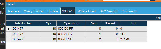

I think I would like the output to be something like this:
Job AsmChain Part Op
12345/1 0> abc123 10
12345/1 0> abc123 50
12345/1 0> abc123 900
12345/1 0>1 def123 10
12345/1 0>1 def123 50
12345/1 0>1 def123 900
12345/1 0>1>2 ghi123 10
12345/1 0>1>2 ghi123 50
12345/1 0>1>2 ghi123 900
12345/1 0>1>3 jkl123 10
12345/1 0>1>3 jkl123 50
12345/1 0>1>3 jkl123 900
Where AsmChain is like the hierarchy path. Here you can see most parts are children of the previous Asm. But Asm 3 is a child of Asm1, not Asm2. I want to see that relationship, regardless of how many levels deep it goes. Does this make sense?

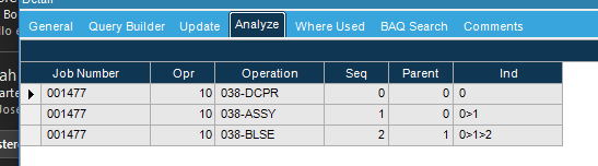

Like this?
Yeah sort of like that!

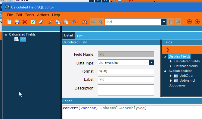

rearranged the calculated field to this.
 * Disclaimer!!!
 * This is not a real query being executed, but a simplified version for general vision.
 * Executing it with any other tool may produce a different result.

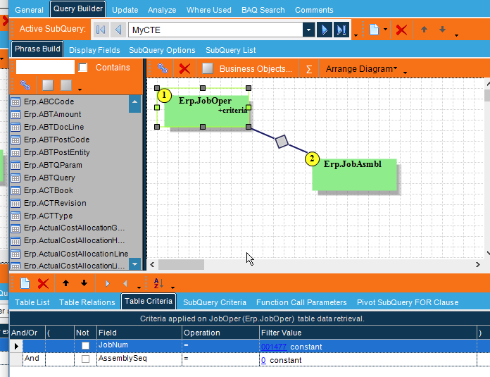

with [MyCTE] as
(select
	[JobOper].[JobNum] as [JobOper_JobNum],
	[JobOper].[OprSeq] as [JobOper_OprSeq],
	[JobOper].[OpCode] as [JobOper_OpCode],
	[JobOper].[AssemblySeq] as [JobOper_AssemblySeq],
	[JobAsmbl].[Parent] as [JobAsmbl_Parent],
	(convert(varchar, JobAsmbl.AssemblySeq)) as [Calculated_Ind]
from Erp.JobOper as JobOper
inner join Erp.JobAsmbl as JobAsmbl on
	JobOper.Company = JobAsmbl.Company
	and JobOper.JobNum = JobAsmbl.JobNum
	and JobOper.AssemblySeq = JobAsmbl.AssemblySeq
where (JobOper.JobNum = '001477'  and JobOper.AssemblySeq = 0)

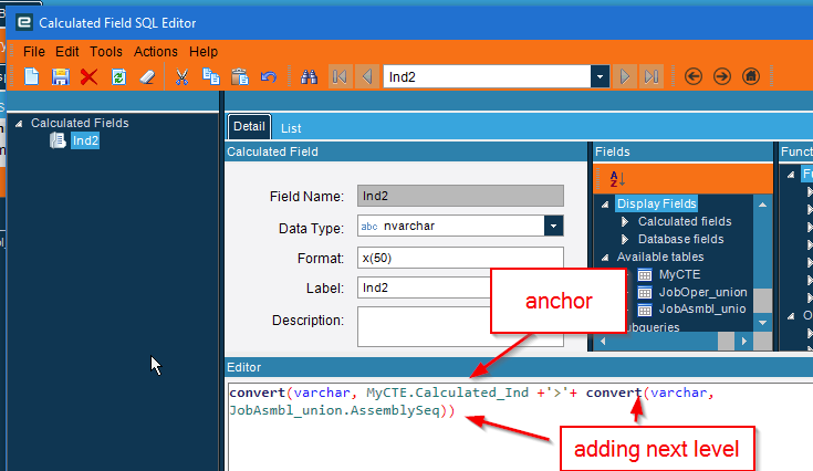

select
	[JobOper_union].[JobNum] as [JobOper_union_JobNum],
	[JobOper_union].[OprSeq] as [JobOper_union_OprSeq],
	[JobOper_union].[OpCode] as [JobOper_union_OpCode],
	[JobAsmbl_union].[AssemblySeq] as [JobAsmbl_union_AssemblySeq],
	[JobAsmbl_union].[Parent] as [JobAsmbl_union_Parent],
	(convert(varchar, MyCTE.Calculated_Ind +'>'+ convert(varchar, JobAsmbl_union.AssemblySeq))) as [Calculated_Ind2]

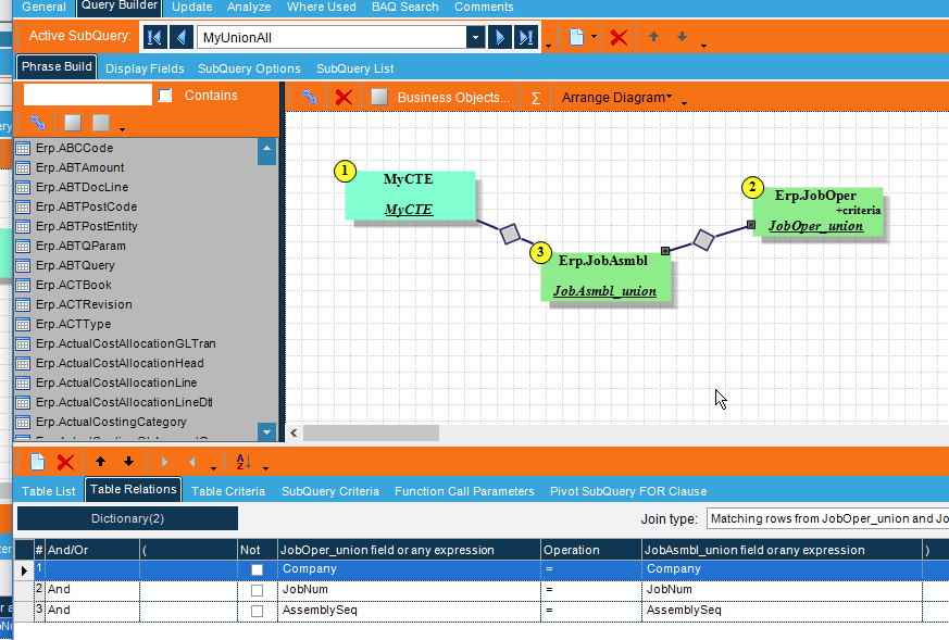

from  MyCTE  as MyCTE
inner join Erp.JobAsmbl as JobAsmbl_union on
	MyCTE.JobOper_JobNum = JobAsmbl_union.JobNum
	and MyCTE.JobOper_AssemblySeq = JobAsmbl_union.Parent
inner join Erp.JobOper as JobOper_union on
	JobOper_union.Company = JobAsmbl_union.Company
	and JobOper_union.JobNum = JobAsmbl_union.JobNum
	and JobOper_union.AssemblySeq = JobAsmbl_union.AssemblySeq
	and ( JobOper_union.AssemblySeq <> 0  ))

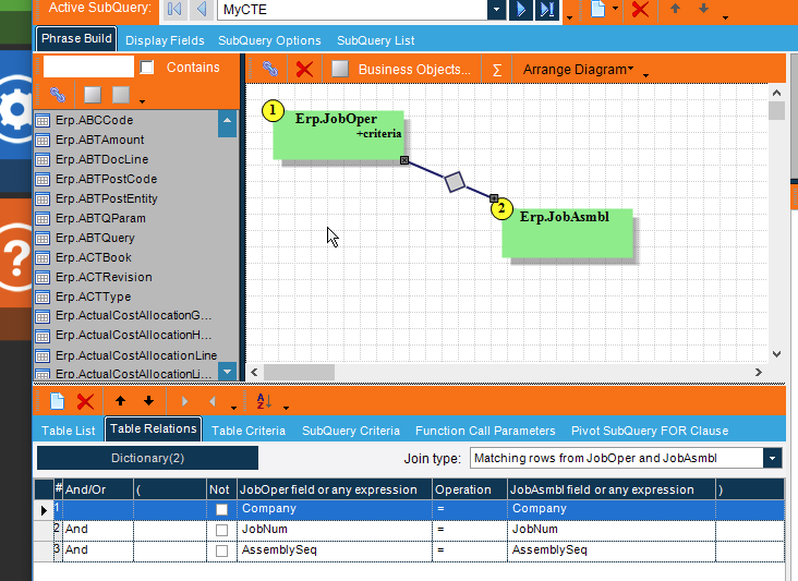

The CTE just has the original, it’s the “anchor” in this case.

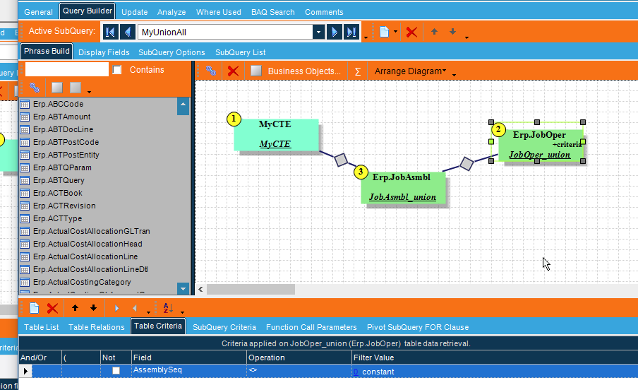

Then the union all has this
the example over complicated things and muddies the waters.

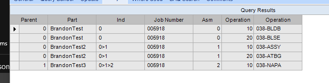

Why are you using distinct? You shouldn’t need that, figure out why you’re getting duplicates.
I thought so too! I had way too many records before I put that in there. I can’t figure out what the duplicates are from. :thinking:

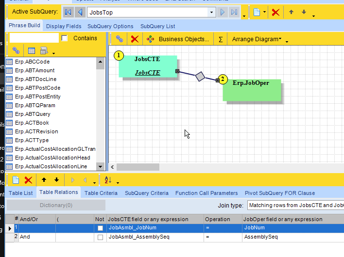

Here’s the CTE

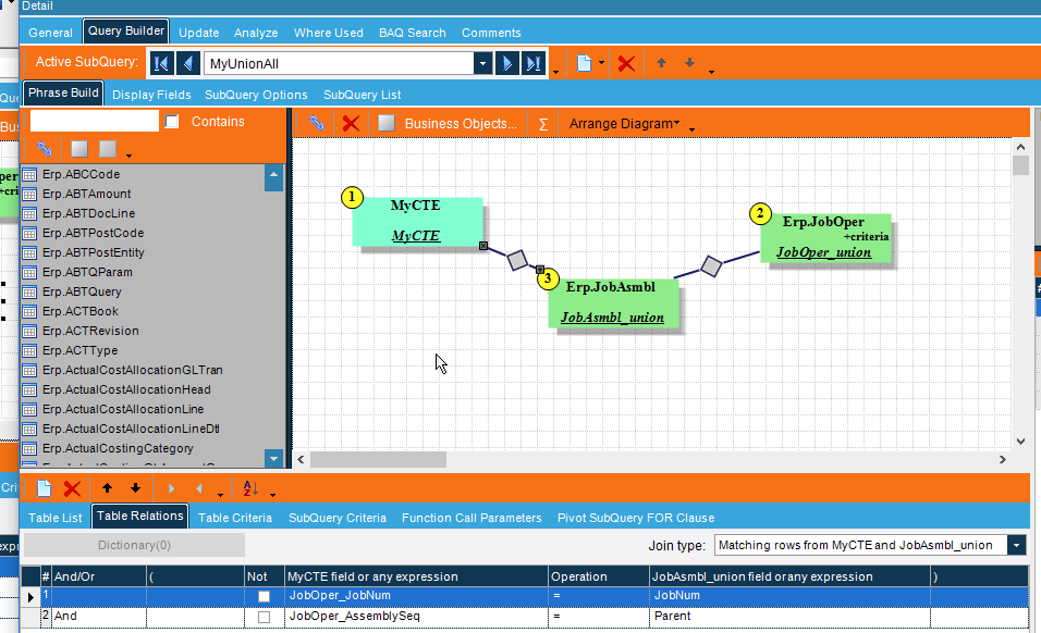

here’s the union
Do your joins/criteria look like that?
I made a couple small adjustments to match your joins. Now I am still getting duplicates in my result.

It has to do with the operation info added. That needs to be removed and added to the top level. (we established that at the beginning, I just forgot when I did my example)
So do everything without the operation information, then at the top level join the operation information.
(get the company in there to join as well, I forgot and am too lazy to fix it)
Here’s the “Fixed” query. You’ll need to adjust your sorting again, but this should work.
OpListForFixturesFixed.baq (39.5 KB)
Yes! This is great! So confusing! I think this exercise has given me a better understanding of CTE recursion. Thank you!
