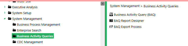

Is there a menu that should says “BAQ Designer”
I was being told that I should see this menu tree:
"you should see:
BAQ Designer
BAQ Search
BAQ Export
BAQ Report Designer"
Could be something someone customized in your environment :man_shrugging:
Its not, the menu I see and have been working with is the same you have show me. I dont know where they got that.
