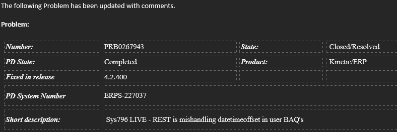

Thank you, I just got a response from Epicor Support showing the same status. They also provided me with PRB0267943.

Does 4.2.400 mean the 2023.2 release?
Nice!
I have confirmed that the 2023.1.12 release fixes the issue for us.
