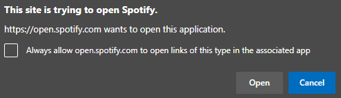

Wow, glad this one was patched: “mailto:test%…/…/…/…/windows/system32/calc.exe”.cmd"
I could use that to send/compile/run arbitrary code on peoples pc with little or no interaction.

As a respected member of RaidForums (shutdown by FBI) and BreachedForums. I endorse the registry edit and powershell answer as a solution. (rubs hands together).
I might should have specified it was an example and proof of concept, not an implementation guidline.
It’s the same process as so many other primarily web-based software that have a desktop application as a complement. It’s completely valid if implemented properly.
