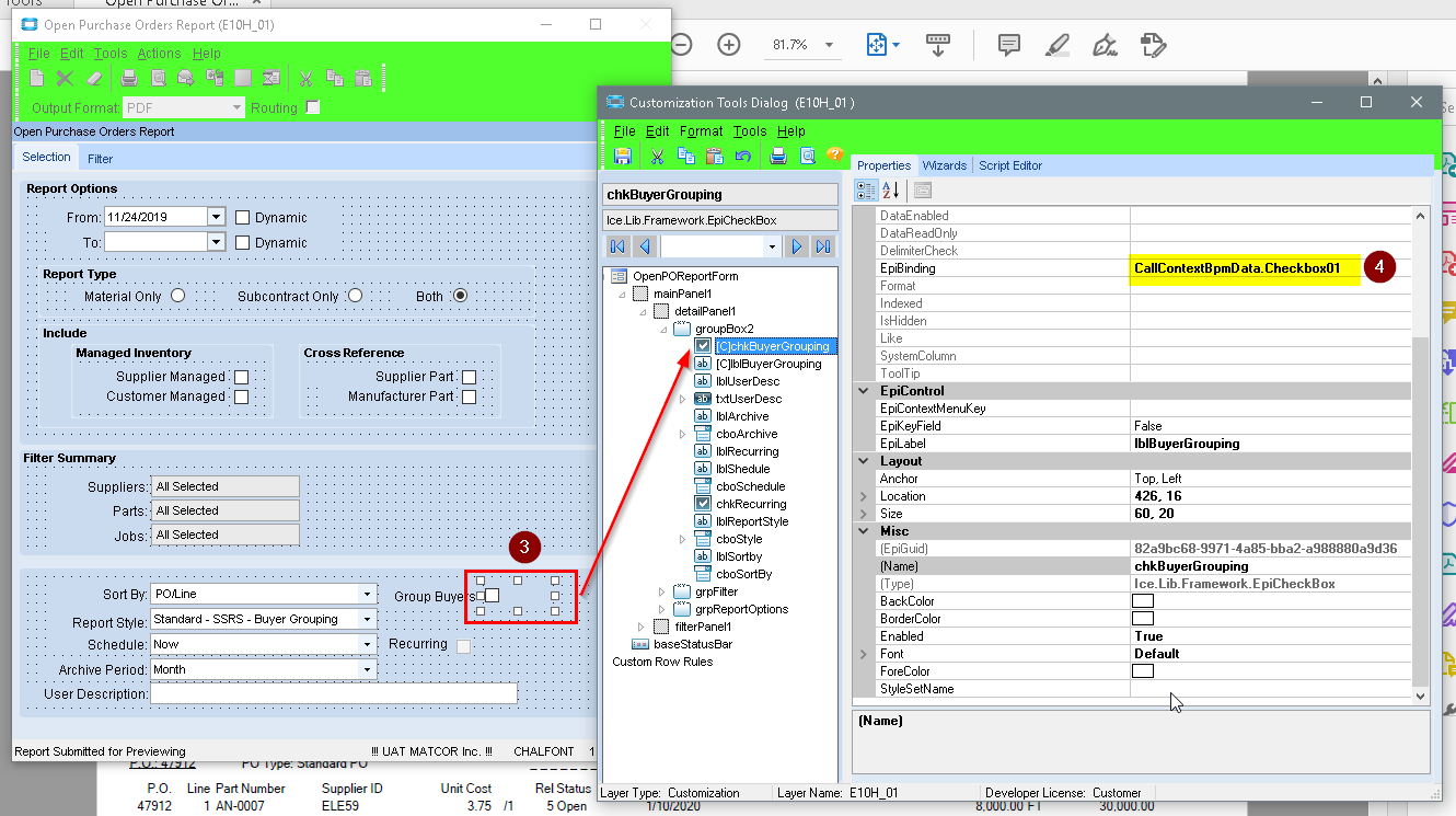

So I think the steps would be:
  • Create a separate menu item to run the mass PO print.
  • Add an application studio layer and add in a token Date Control
    • Set the EpiBinding to CallContextBpmData.Date01
    • Set the EpiBindingShowToken to CallContextBpmData.CheckBox01
    • Set the EpiBindingToken to CallContextBpmData.Character01
Use this excellent post to create a function that you can convert the token date to true date, bind it to another CallContexteBPMData.Date field.
  • Publish the layer
  • Modify the SSRS report
    • Add in another dataset to the RDL for the CallContextBPMData
      Something like
="SELECT T1.Date01 [EpiBinding], T1,Checkbox01 [EpiBindingShowToken], T1.Character01 [EpiBindingToken], T1.Date02 [TrueTokenDate] FROM CallContextBPMData_" + Parameters!TableGuid.Value + " T1"
or
Add join the CallContextBPMData directly to the main POHeader dataset like
LEFT OUTER JOIN CallContextBPMData_" + Parameters!TableGuid.Value + " T5 ON T5.RowMod = 'U' "
  • then you should be able to put a where clause in against the pO date and date passed in from the token field.
