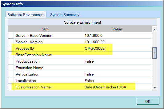

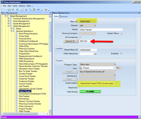

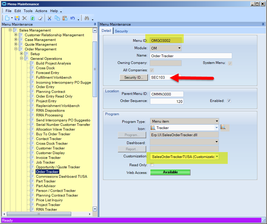

In case it helps anyone else… many times I also go to the program that’s opened and go to the Help / About Epicor / system Info / Software environment tab to see which Process ID has been called to open the program (screenshot 1). When the security is assigned in the menu to that one (screenshot 2), it opens the customization associated and used the security id assigned.
