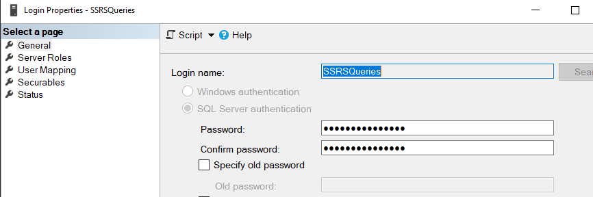

Sure, we do create a specific Login and lock it down to the minimum that it needs:
Which I know is still not the most kosher, but is it egregious enough to tell the business they cannot have the feature they want?

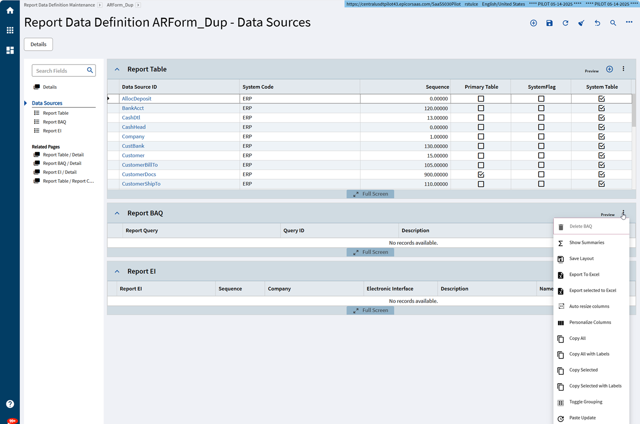

Brain foggy… did they add the ability to put BAQs in out of the box RDDs?
I haven’t tried since 24.x so I just tested in 25.1 and can’t add a BAQ to a copy of ARForm RDD.

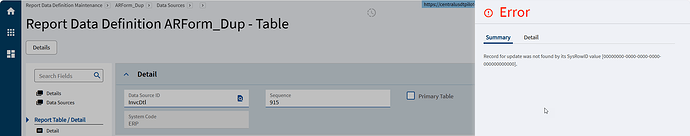

That or add a copy of a table in the RDD already as an alias (i.e. adding InvcDtl again or Customer, etc.)_
Thanks for confirming that Randy.
What I mean is @Randy, sometimes there are some linked tables in an RDD that are linked on a key in say, invcdtl, but I need them to be linked on a different table as well as that table. Maybe I am overthinking it, but that’s a common scenario I run up against.
Looks like a no

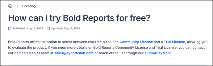

Looks like they have (2) options for trial.
