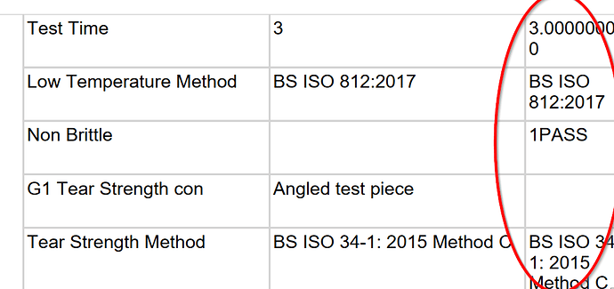

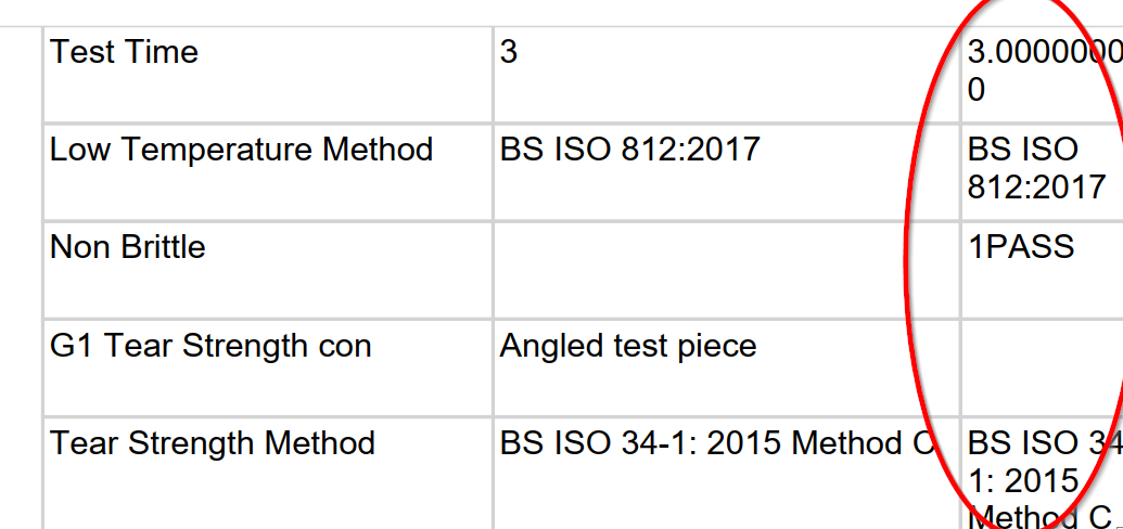

results in a 1pass being output

You are getting the 1 because the first is evaluating to a 1.
My guess would be that
  1. AttrIdent = Result is true, leading to ResultValue = 9999 being tested.
  2. ResultValue = 1 (or possibly "1")
  3. Regardless of IsNumeric(Fields!ResultValue.Value) being true or not, ResultValue will be displayed.
Yes youve just been working on the last part.
So what is happening is that all AttrIdent types are now showing a value on right hand side, where as before it would only show a value if it was an AttrIdent of type Result
so you need to add that condition to the 2nd and 3rd parts
