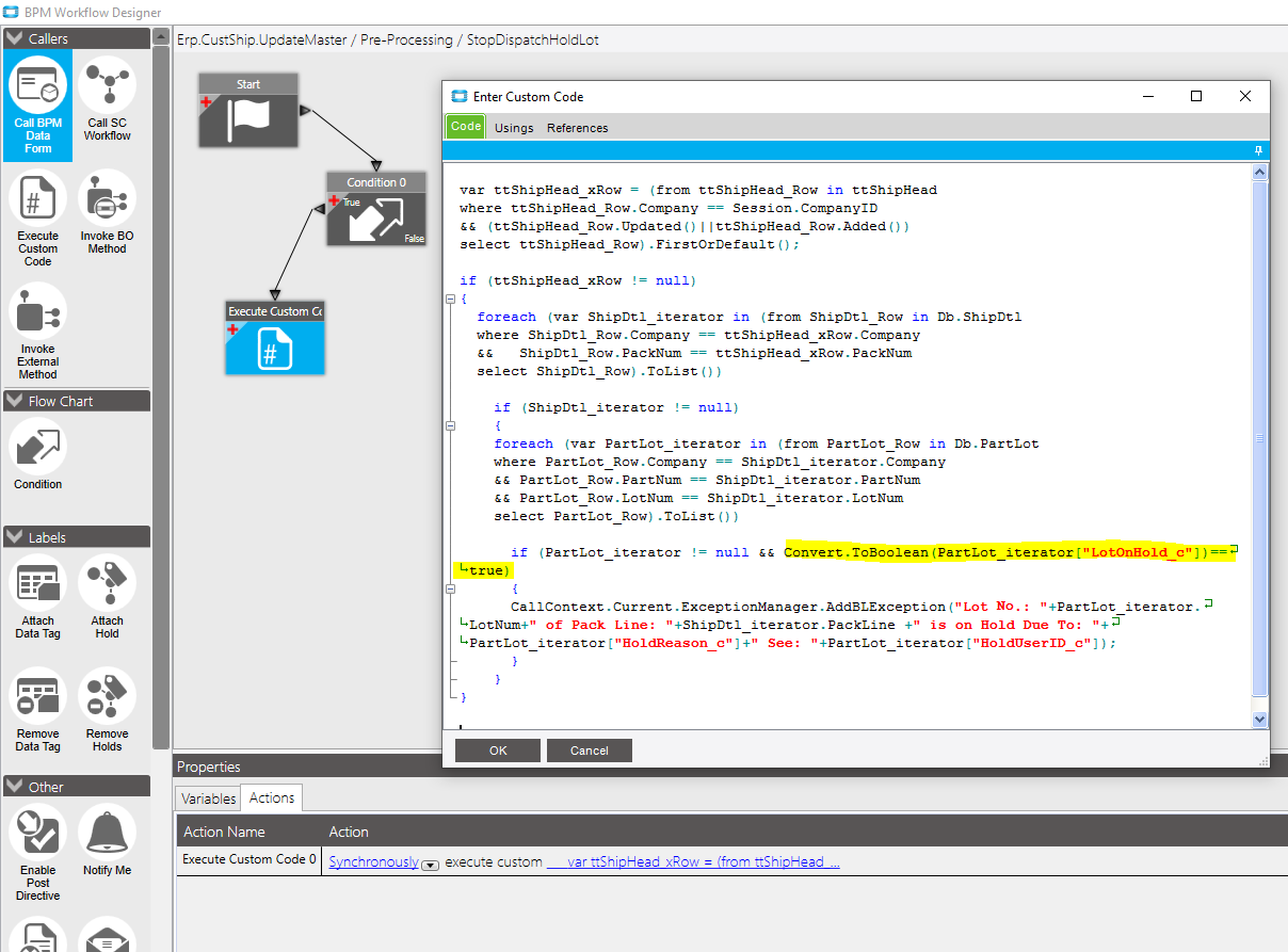

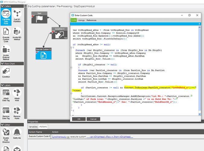

here you are mate, the highlghted code line is my UD field:
the code as text if that helps:
var ttShipHead_xRow = (from ttShipHead_Row in ttShipHead
where ttShipHead_Row.Company == Session.CompanyID
&& (ttShipHead_Row.Updated()||ttShipHead_Row.Added())
select ttShipHead_Row).FirstOrDefault();
if (ttShipHead_xRow != null)
foreach (var ShipDtl_iterator in (from ShipDtl_Row in Db.ShipDtl
where ShipDtl_Row.Company == ttShipHead_xRow.Company
&& ShipDtl_Row.PackNum == ttShipHead_xRow.PackNum
select ShipDtl_Row).ToList())
	if (ShipDtl_iterator != null)
	foreach (var PartLot_iterator in (from PartLot_Row in Db.PartLot
	where PartLot_Row.Company == ShipDtl_iterator.Company
	&& PartLot_Row.PartNum == ShipDtl_iterator.PartNum
	&& PartLot_Row.LotNum == ShipDtl_iterator.LotNum
	select PartLot_Row).ToList())
		if (PartLot_iterator != null && Convert.ToBoolean(PartLot_iterator["LotOnHold_c"])==true)
		CallContext.Current.ExceptionManager.AddBLException("Lot No.: "+PartLot_iterator.LotNum+" of Pack Line: "+ShipDtl_iterator.PackLine +" is on Hold Due To: "+PartLot_iterator["HoldReason_c"]+" See: "+PartLot_iterator["HoldUserID_c"]);
