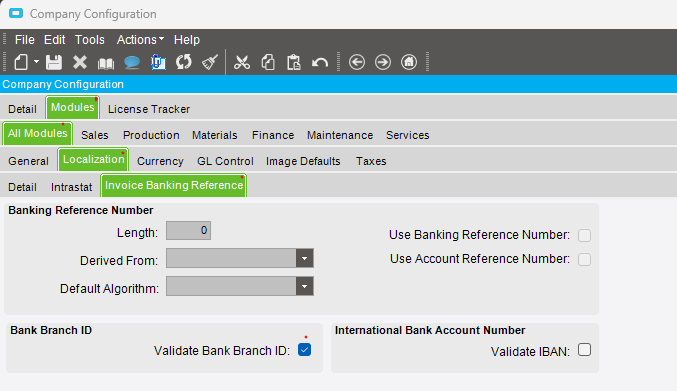

In the application help it says this,
[BankID] is required if the Validate Bank Branch ID check box is selected on the Invoice Banking Reference sheet in Company Configuration
You can see it in the company configuration section pictured below:
thank you. I’m playing in our Pilot trying to find this kind of thing.
