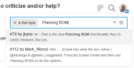

Unrelated fun fact - when a thread is this long (100+ replies), Ctrl+F does not find everything if it’s not loaded.
But that is the advantage of the site’s search “in this topic”:
The following links should give you a decent start, or at least let you know if it’s worth investigating any further…
