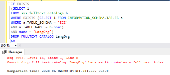

Upgrade issues 2021 / 11.1.100.26 to any major release above
Now that you’ve dropped the full text index, it should now be able to drop the catalog.
IF EXISTS
(SELECT 1
FROM sys.fulltext_catalogs b
WHERE EXISTS (SELECT 1 FROM INFORMATION_SCHEMA.TABLES a
WHERE a.TABLE_SCHEMA = ‘ICE’
AND a.TABLE_NAME = b.name)
AND name = ‘LangOrg’)
DROP FULLTEXT CATALOG LangOrg
GO
:frowning:
I have the full-text service stopped also in case it was regenerating.

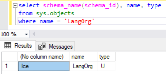

I wonder if you have db objects in your database with the same name as LangOrg. Maybe a view?
Please run the query below.
select schema_name(schema_id), name, type
from sys.objects
where name = ‘LangOrg’

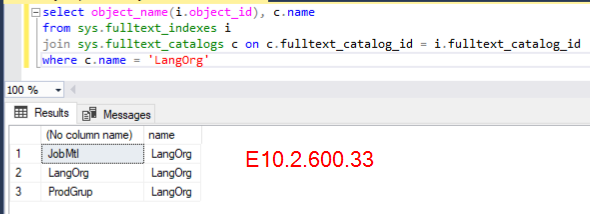

Bad news, same circular pattern with the E10 database. However, I am going to try and do it the traditional way and see what happens.
Ok, at least we know there is only one object in your database with the name LangOrg. I am aware that you can only have one full text index in any table or view. I will continue looking into this.

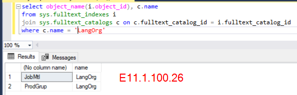

We can also try to see what object does it sees that has the catalog name of LangOrg.
select object_name(i.object_id), c.name
from sys.fulltext_indexes i
join sys.fulltext_catalogs c on c.fulltext_catalog_id = i.fulltext_catalog_id
where c.name = ‘LangOrg’
(E11 after our modifications)
Maybe a customization we paid for between JobMtl and ProdGrup might be part of the culprit. I cant fully recall what it was but might have used these tables.
Well, that is why we can’t drop the catalog. There are two other objects that use the same catalog names. This is very odd.

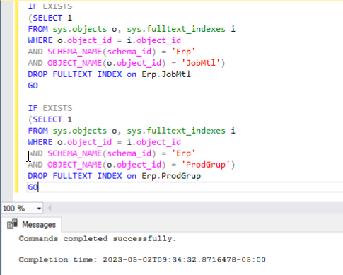

I was suggesting of dropping the full text index on those two tables. We not going to drop any indexes other than the full text index created on these objects. These are not part of our base product.
IF EXISTS
(SELECT 1
FROM sys.objects o, sys.fulltext_indexes i
WHERE o.object_id = i.object_id
AND SCHEMA_NAME(schema_id) = ‘Erp’
AND OBJECT_NAME(o.object_id) = ‘JobMtl’)
DROP FULLTEXT INDEX on Erp.JobMtl
GO
IF EXISTS
(SELECT 1
AND OBJECT_NAME(o.object_id) = ‘ProdGrup’)
DROP FULLTEXT INDEX on Erp.ProdGrup
GO

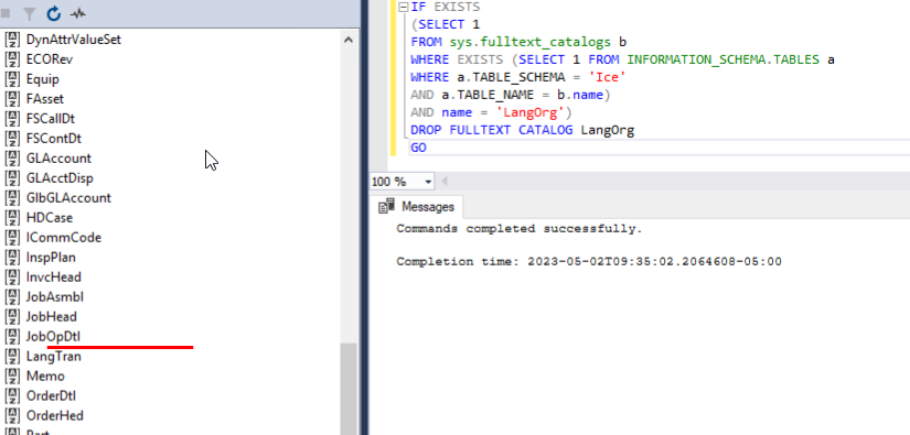

Once these are dropped, please see if you can now drop the LangOrg full text catalog.
IF EXISTS
(SELECT 1
WHERE a.TABLE_SCHEMA = ‘Ice’
GO

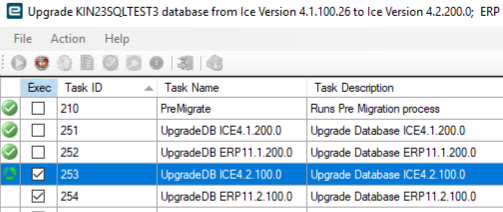

Its gone from catalog now =)
It should not stop at that error now, i’ll load it and see what happens.
Thank you so much for digging into this, we would have been stuck on this version of Epicor.
Darn customizations, we dont have many but they’re always the problem in upgrades. I think the custom table was mainly created for the Product Configurator, but it is also used on the part table.
It’s happy now. Made it past Task 251
