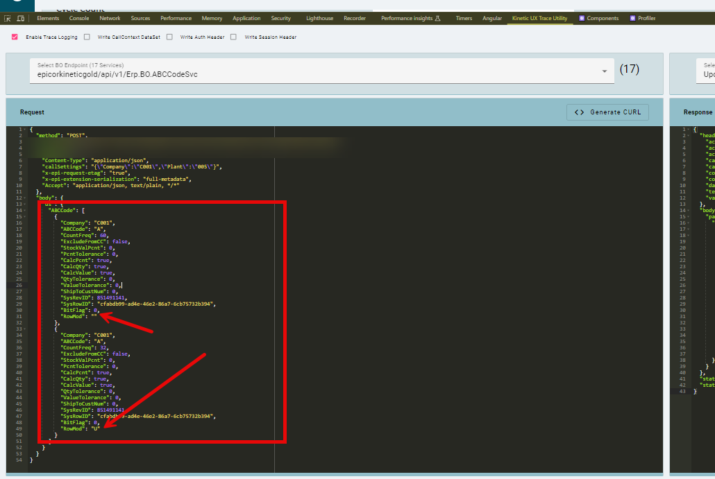

85% of the time it doesn’t matter… that last 15% will bite you in the :peach:. Technically any time we call the BO’s (server side) we should pass in a BeforeImage with every call. But is is tedious and so most of us only do it when forced to.
In the new REST Calls in Kinetic UX if you look at the Network Monitor you will see that every record that is sent from the UX has those 2 records one with a RowMod and one without.
