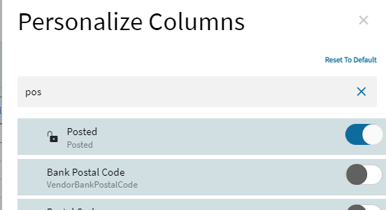

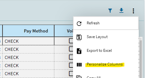

One your Payment Tracker, you can use the overflow menu and ā€œPersonalize Columnsā€.
In there, you can search for ā€œpostedā€:
Turn that column on. I’m pretty sure it is not on by default. You can do the same with ā€œGroupā€.
But… since you’re saying you still see it on Aged AP and you don’t see a check number, it probably isn’t posted. But I was hoping you would see what Group you were using.

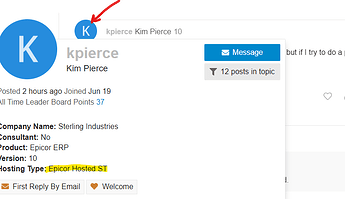

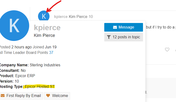

How do I know which version of Epicor I have? What is a kinetic screen in your last email?
Haha, I’m not a stalker, I swear.
If you click on anyone’s Avatar (in your case just a ā€œKā€), it opens up info on their profile. At some point you put ā€œEpicor Hosted STā€ in your profile.
