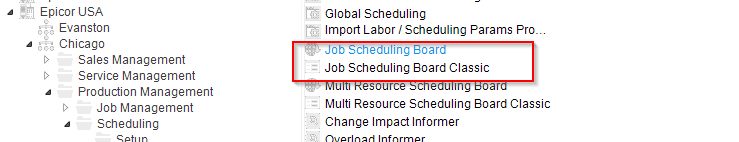

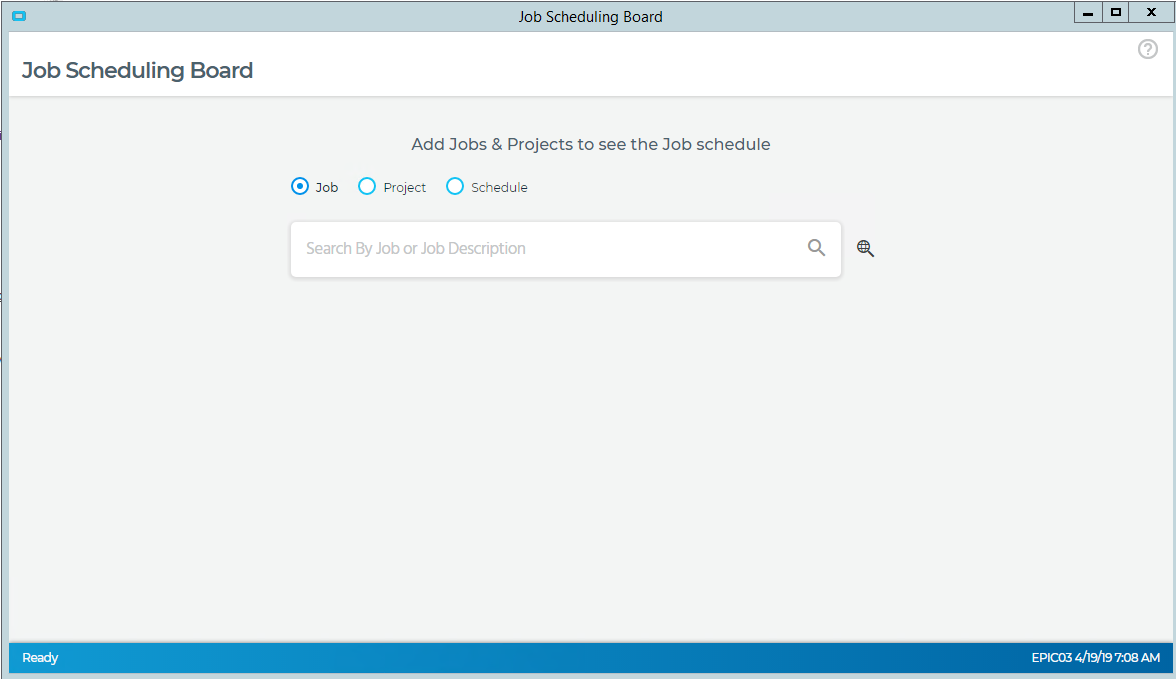

Here are the search screens
I only said that Dan is smarter AND better looking than I am…
Does this show up as a new menu item or does it replace the existing one? My assumption is that Epicor will build new BO’s / forms / reports as V2 and leave the legacy code in place?
You will still be able to access the Classic Scheduling Board they will appear in the Menu with the word Classic.
