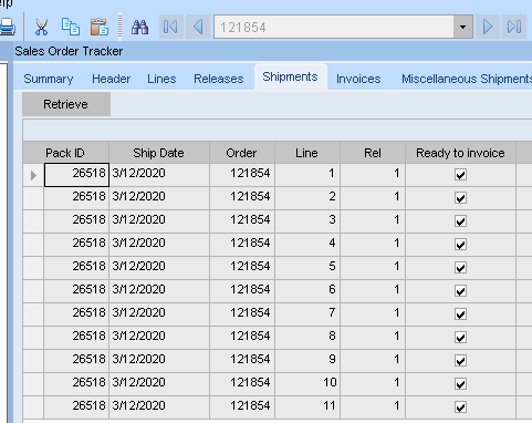

1 Shipment, 2 Invoices?
We had 1 shipment for an SO, and 2 invoices were generated. The SO has 11 lines, and one invoice had the 1st line, and the 2nd invoice had the remaining 10 lines. Any idea why we wouldn’t get 1 invoice for 1 shipment?
