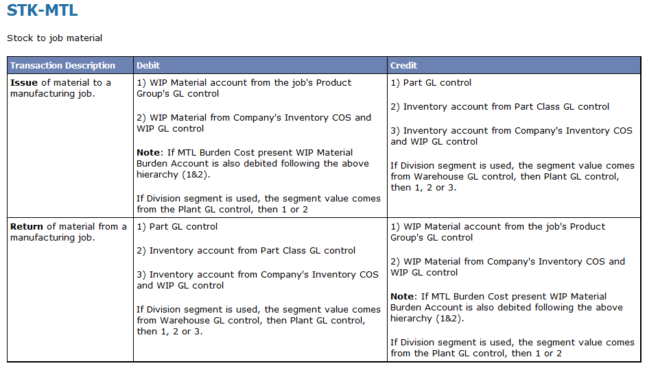

Agreed with Andy. I’m on 905702, so this may not apply quite the same in 10, but I would certainly hope there is something similar. One place that I have found really helpful to look when troubleshooting GL issues is the Epicor help.
F1 -> General Ledger -> Working with the General Ledger -> Inventory Transaction Hierarchy (or whichever one is applicable) -> Find your transaction type. You can see the default control codes and contexts that Epicor will use, assuming you haven’t customized your posting rules. Those are the accounts I would start with, here’s a screen shot from 905702.
