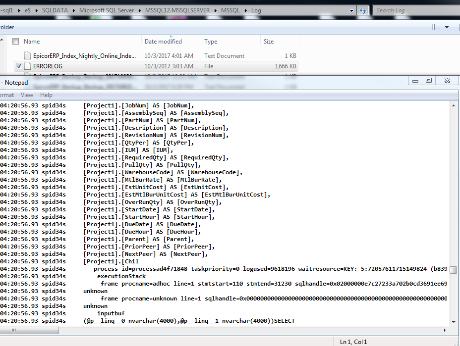

You might want to enable all the T-Flags in SQL that the Performance and Diagnostic Tools tells you to enable and glance at your SQL ErrorLog once in a while - you might have alot of deadlocks you dont know about.
Just an Internal Email I sent:
I glanced at the SQL Error Logs yesterday and notice that for the past 7 days there are some weird deadlocks on LaborDtl and then I looked at all the AppServer log files going back 14 days and starting last Wednesday – Today. The deadlocks are consistent with times of Clock In/Clock Out or Perhaps Start/End Activity (AM, Lunch, PM). The odd part is that Monday, Tuesday there was no issue(s) yet we were on .26 long before that. It started on Wednesday+.
I couldn’t replicate it in TST I grabbed a bunch of random Employee Numbers and started hammering Clock In / Clock Out, Start / End Activity – Could be a special Job that somehow has Children or some loop.
I didn’t notice any data corruption or gaps, however I could be missing something and that is what worries me what does this deadlock do if left unfixed. I enabled SQL Profiler Tracer and I am in the process of collecting the proper information to send to our Deadlock Expert at Epicor to find out what is going on and are we causing data corruption.
