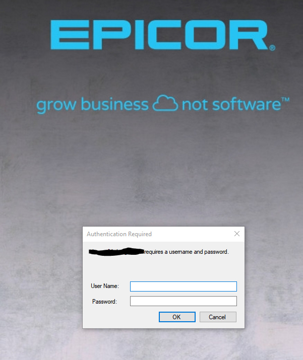

I updated my appserver to use Windows binding to get single sign-on working in 10.2.200. Now, when I open the client it automatically uses the Active Home Page, but before it will login I get an “authentication required” pop up. It says a username and password is required to access the application server. I key in my Epicor username and password. All is well, but with single sign on I would think this login should not come up. Am I missing something in the REST services configuration. Anyone have any ideas?

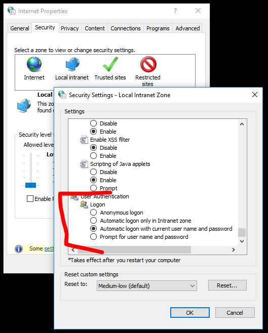

Are your Internet Options set to auto sign in or prompt for the domain of the server?
I just updated this setting to Automatic logon with current user name and password. It was set to Automatic logon only in Intranet zone. Closed IE and closed Epicor client. Open Epicor Client and the same authentication pop up occurred. I assume this is a local client setting. Going to try a reboot and see what happens.
@Bart_Elia a reboot did not solve the issue either. I am set to the same option in your screen print and still getting this pop up as I log in.

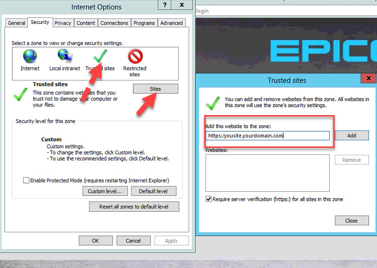

2.) Add your website to the “Trusted Zones” and make sure it “sticks”

When you say add my website. What are you referring too? The URL for the appserver?

Trusted Site:

i did enter the URL within the Local Intranet zone, as by Default Internet Explorer does login automatically then, (no other adjustments required)

I am still confused here. I am using the primary executable and I believe it is defaulting to IE settings, but that additional authentication screen is still coming up. I am going to open a support case on this issue.
Hello everyone I got this problem solved. There was two areas that did not auto set in the installation. I am not sure if the installation build up of the Application server should do this or not, but here is what I had to do to fix this error.
In IIS I had to verify Windows Authentication was enabled for the web site being used. It was set to “disabled”. Once I enabled this this it worked fine for logging into the system with single sign-on.
Secondly, once the certificate is created in the admin console. You need to ensure it is correctly loaded into the Trusted locations. Once this is done the application server build out can successfully load it into the database. This will also allow the REST services page to come up properly on the server. Once this cert is loaded on the client then the REST services help page will come up without error there too.
