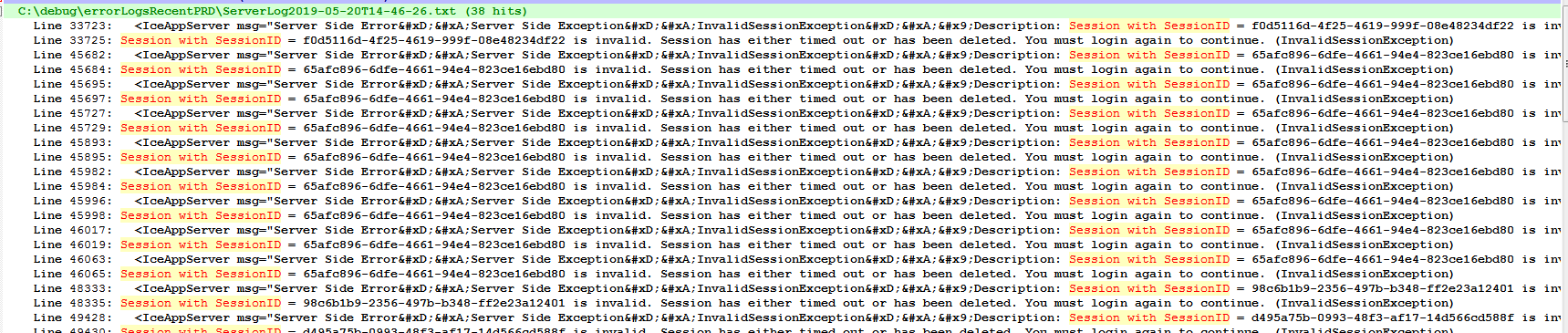

I couldn’t find anything in the Release Notes, so, HotFix for ERPS-115583 is PRB0212766: Sessions are not cleared during an upgrade.
A new property was added to the Session Object for 10.2.400. If the old sessions cached to db are read after an upgrade, the error is not handled and the server is destabilized in numerous ways ranging from a simple UI issue in Admin Console Session List to poor performance due to Task Agent getting backlogged due to the corrupt Sessions.
The orphaned Sessions from 300 should be deleted during the upgrade process
The presence of a corrupt Session being deserialized from the db should be handled more gracefully with proper logging and removal from the db if corrupt.
May explain why I have alot of Session Errors in Log on 10.2.300.13 – but for ERPS-115583 all I know it has a Resolution as Fixed in 10.2.500 I hope they also release a HotFix in 300 – or may not be related… monitoring my logs daily for this :slight_smile:
