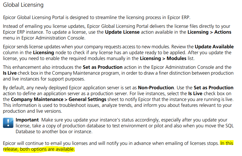

I’m probably missing something since I blew through this install, but one of the setup questions when installing the new version of service connect asked about the license file location.
One option was to point to a folder where the license file exists. The other option was to look at the server for the license service.
I could not get the license service option to work, so instead I took a copy of my old license file and put it in a folder.
What I am concerned about is it seems that license file delivery has changed in EAC 10.2.500. It appears to be delivered differently now.
Has anyone else experienced that?
I think you will still able to use the regular way. I know Epicor added Global Licensing in 10.2.500 – not sure if its prime yet, but the intent is that Epicor and probably even SC can just query Epicor for a license, without you having to wait for your CAM to email you it always.
