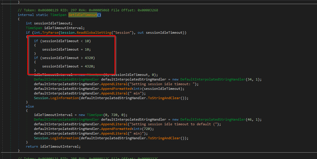

Heads up on this topic. Come 2022.2 (as far as I know might be slightly earlier) there has been an idle timeout setting added to appserver settings.
It is defaulted to 12 hours so you will likely see this error more.
Lower limit is 10 minutes idle and upper limit is 3 days idle. No way to disable it that I can find.

It actually took effect in 2022.1, I had a case open with Epicor Support over it, not realizing this setting existed on the App Server. I found it a few weeks ago and changed it back to 3 days.

There’s no reasonable way around it either, it’s hard coded right into session.

Checking one last avenue to override it. Blanket limit will cause us issues. Timeout by user would be great, by license type, but blanked… booooo
