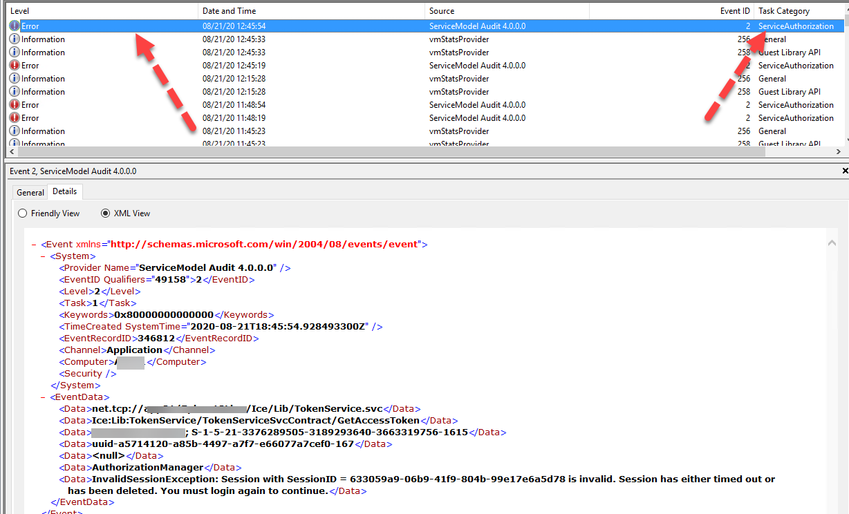

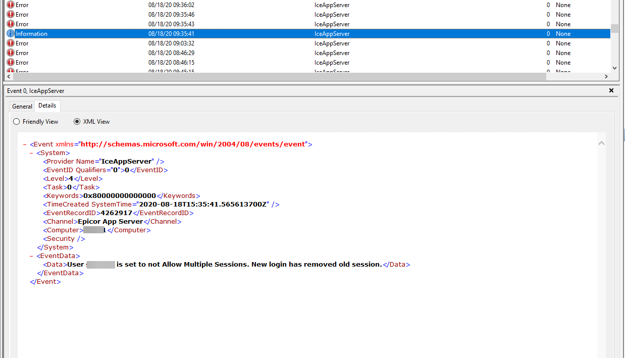

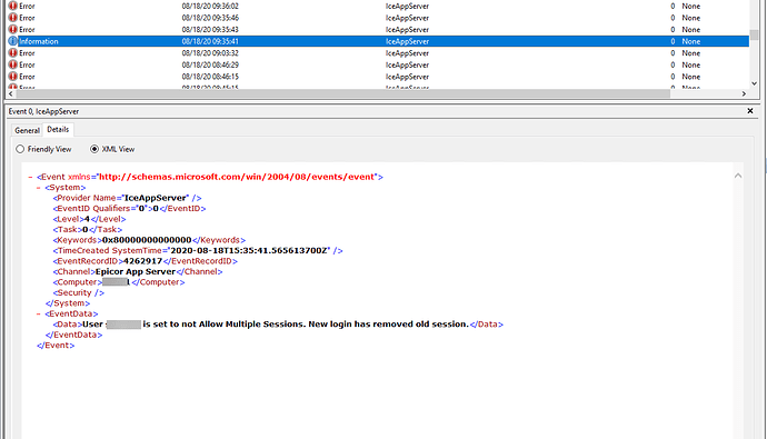

I’m seeing a crap ton of exceptions being thrown in my event viewer related to Invalid Sessions. In previous versions, I don’t see this error being logged.
It looks like the event viewer is capturing both an informational message when a session has expired and an exception message
While it may be an exception in the truest sense, is there a setting to suppress this particular message? Sessions expire all the time and in my mind are not worthy of clogging up the event viewer logs with errors…

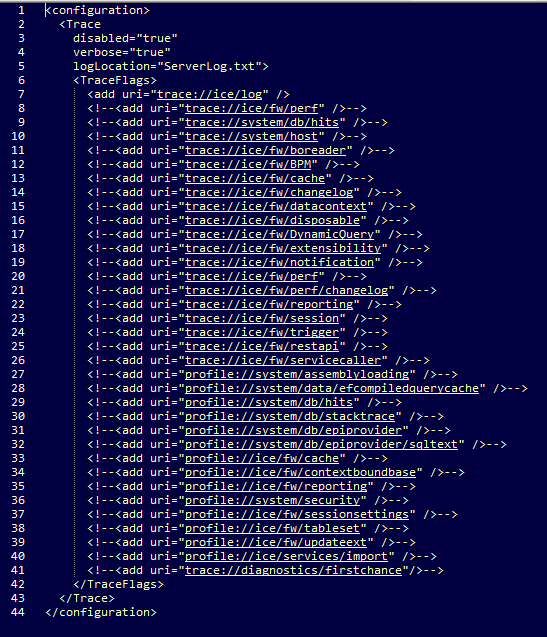

Doesn’t need a recycle and you can turn any of them depending on what you want to do,
Just flipping disabled = false will turn them on right away.
But you only need this if you are trying to evaluate some bugs or something not in general something I recommend to leave on.

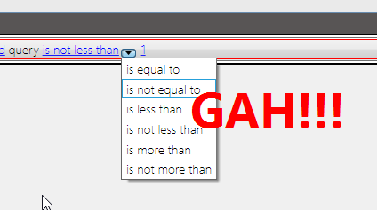

<rant>
Also Epicor for the love of god stop using inverted booleans for your "positives" its so nutty
Disabled = false shouldn't be the way to turn something on....
They do this too on conditions on BPMS and several other places its infuriating
"Not less than"....
GAH! 😡😡😡😡
</rant>
However, the “is not less than” and “is not more than” is the way to get to “greater than or equal” and “less than or equal” so I won’t give them a failed=true on that one example. But otherwise, I don’t disagree with you.
LoL @Mark_Wonsil the fact that I had to read your comment 3 times to understand it should be enough to prove that their stupid logical operators are dumb hahaha!
Ok so as far as I can tell, this exception is being thrown when an idle session is re-started by the user.
The Old session (cached) is now invalid and when they attempt to use it, it throws a server side error, gets a new session, and carries on.
The real question for me is again, is there something I can do to prevent this from being a logging event-worthy exception? I don’t recall this in older versions, so perhaps someone can take a look at theirs to see similar events?

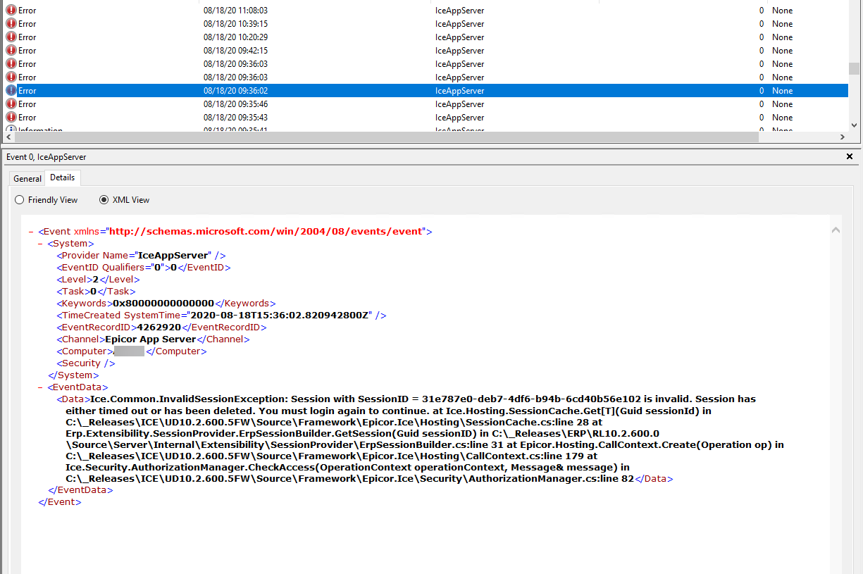

<Session msg="Server Side Error" machine="APP01" pid="3528" tid="269"/>
<Op Utc="2020-08-21T18:45:54.9284933Z" act="Ice:Lib:TokenService/TokenServiceSvcContract/GetAccessToken" correlationId="0365dc2c-3d1f-4822-905e-de820479264d" dur="3.6984" cli="{ip}" usr="{user}" machine="{server}" pid="3528" tid="269">
<Session msg="Could not find an existing Session in Cache. ID: 633059a9-06b9-41f9-804b-99e17e6a5d78" />
<Exception><![CDATA[Ice.Common.InvalidSessionException: Session with SessionID = 633059a9-06b9-41f9-804b-99e17e6a5d78 is invalid. Session has either timed out or has been deleted. You must login again to continue.
at Ice.Hosting.SessionCache.Get[T](Guid sessionId) in C:\_Releases\ICE\UD10.2.600.5FW\Source\Framework\Epicor.Ice\Hosting\SessionCache.cs:line 28
at Erp.Extensibility.SessionProvider.ErpSessionBuilder.GetSession(Guid sessionID) in C:\_Releases\ERP\RL10.2.600.0\Source\Server\Internal\Extensibility\SessionProvider\ErpSessionBuilder.cs:line 31
at Epicor.Hosting.CallContext.Create(Operation op) in C:\_Releases\ICE\UD10.2.600.5FW\Source\Framework\Epicor.Ice\Hosting\CallContext.cs:line 179
at Ice.Security.AuthorizationManager.CheckAccess(OperationContext operationContext, Message& message) in C:\_Releases\ICE\UD10.2.600.5FW\Source\Framework\Epicor.Ice\Security\AuthorizationManager.cs:line 157
at System.ServiceModel.Dispatcher.AuthorizationBehavior.Authorize(MessageRpc& rpc)
at System.ServiceModel.Dispatcher.ImmutableDispatchRuntime.ProcessMessage11(MessageRpc& rpc)
at System.ServiceModel.Dispatcher.MessageRpc.Process(Boolean isOperationContextSet)]]></Exception>
</Op>

I definitely feel like I’m taking crazy pills too because I see in the event viewer this has been happening forever, it’s not just a 10.2.600 thing. Would love to see if other people are logging these events
There is special flag called Allow multiple sessions flag that allows Epicor user create as many sessions as needed, when switching between companies. But every session means new license consumed.
So to avoid overconsumption this flag in user setting is sometimes switched off.
In this case, when user changes company, existing session is removed from server cache and only new session is valid now. Only this new session should be sent to the server in the header, and old session should not be sent to the server anymore.
Looks like there is a bug in the client code, that still sends that old session with some client calls, and that results in the exception you see. If you did not see that before, probably it is some new functionality, like kinetic home page stuff? Can you reproduce steps when this happens? It usually involves company/site switching.
You can trace when sessions are created or removed with ice/fw/session trace flag.
