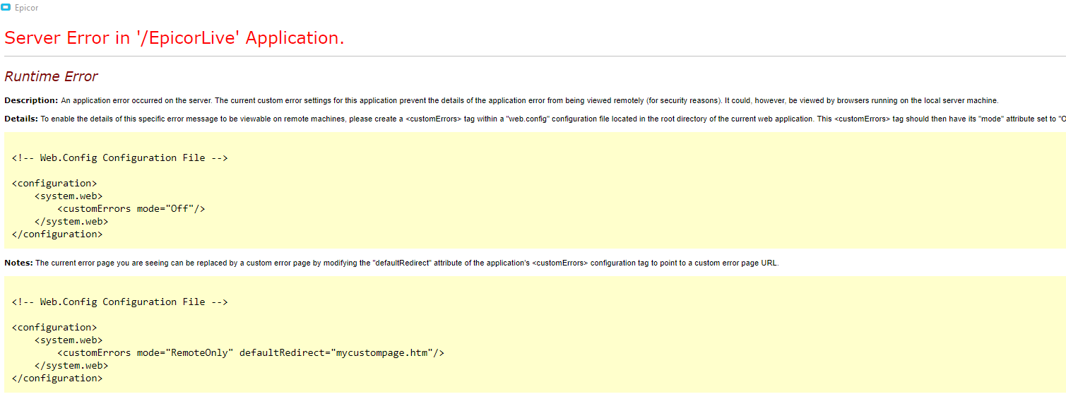

i did 10.2.600 upgrade but i think i missed the SSL certificate part. When i try to load kinetic home page, i get following error:

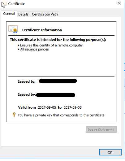

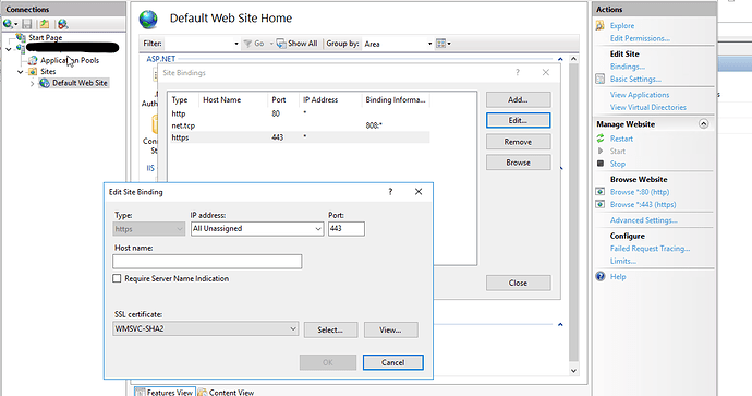

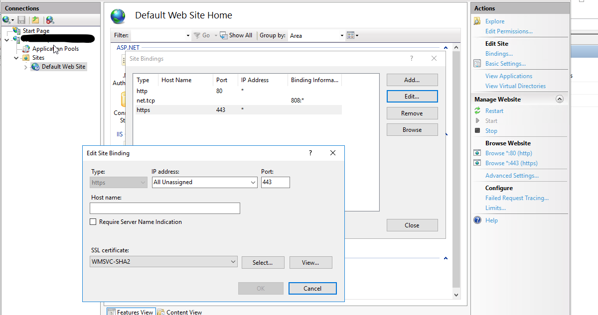

here is the cert settings on IIS pool

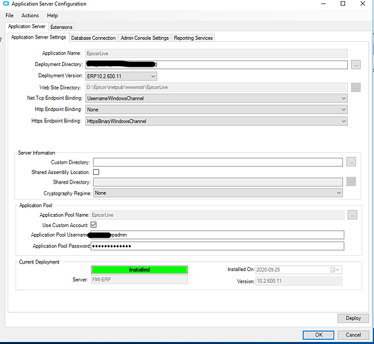

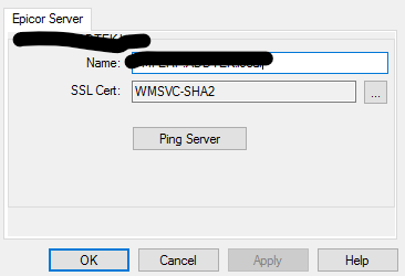

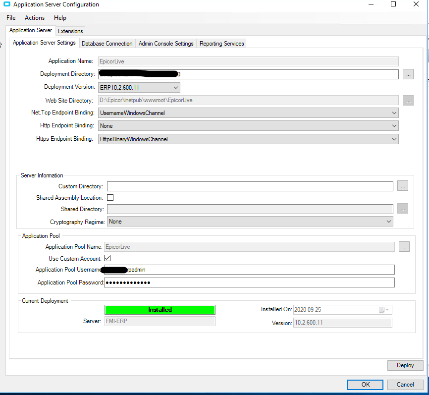

here is the setting on Epicor App server:

Is the certificate valid?
looks valid to me.

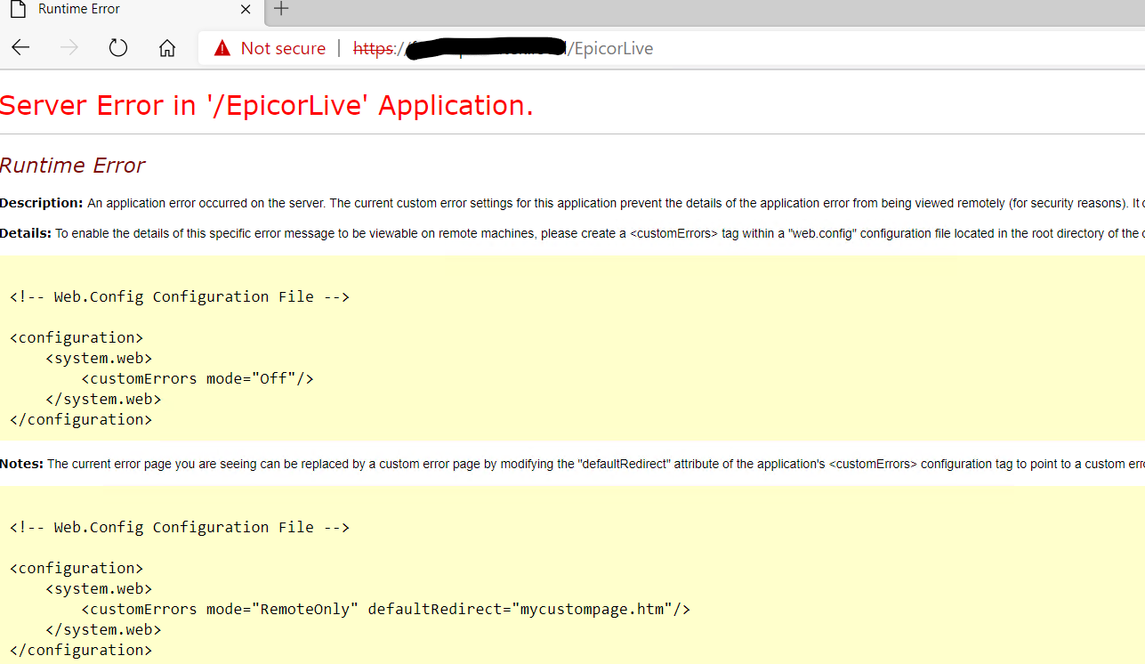

What do you see in the browser if you navigate to https://yourservername/epicorapppool ?
get the same error when browse to above mentioned address

Also do you want HttpsBinaryWindowsChannel
it was an upgrade.
I dont think i want HttpsBinaryWindowsChannel. I think i added that as the part of troubleshooting process.
Will probably remove it.

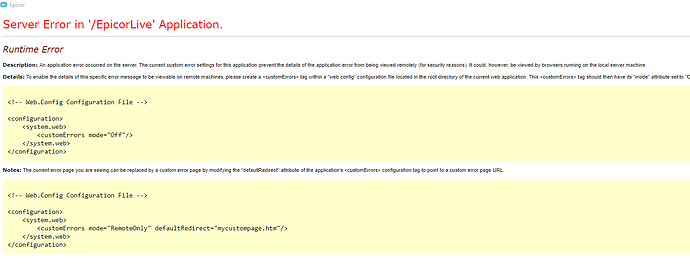

Support just got back and suggested to update .Net version in web.config file. Will see if that helps. It was 4.0 instead of 4.8
You should compare your web.config with web.config.template

If you open browser with that address on that server machine, the error will be shown right in the browser.
So far I can only tell that “Not secure” in the browser address line is not connected with the yellow error you see. These are 2 different problems.
Support fixed the issue.
Somehow web.config for live did not update properly to have correct assemblies. Support tech compared and fixed the live config file with pilot and made changes for live one.
