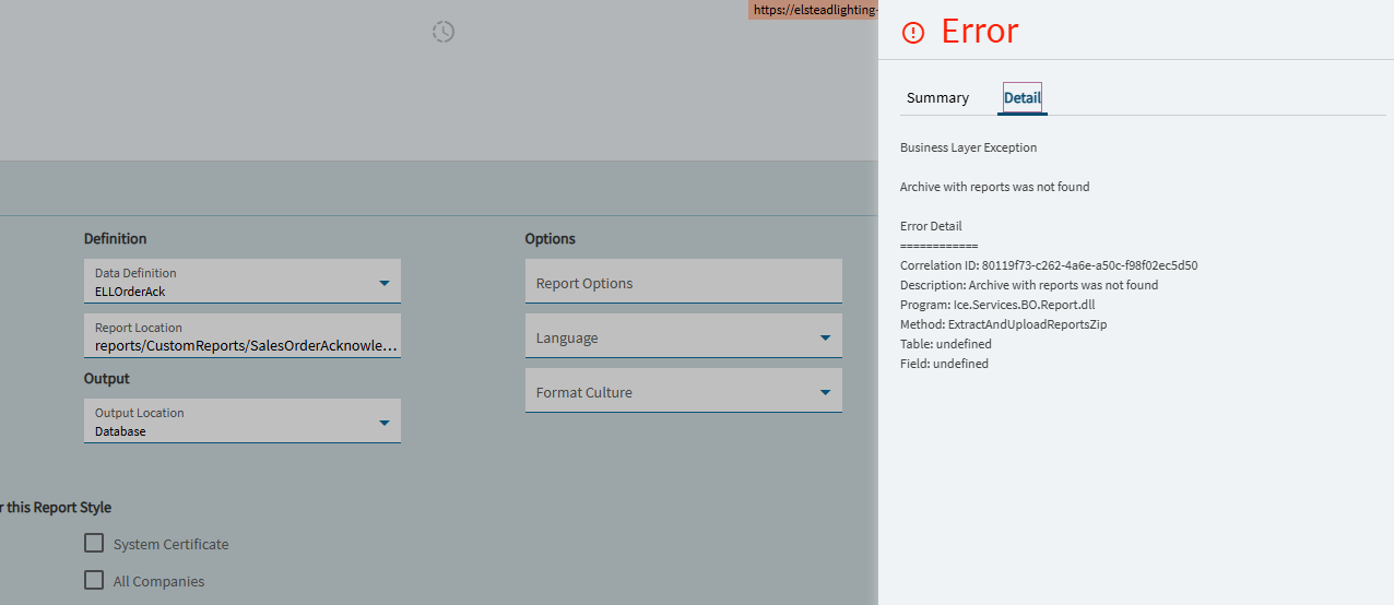

Hello, we have just started testing our Kinetic Upgrade however we have 100 custom SSRS reports in 10.2.700 I was told to zip the reports and upload them to kinetic one by one but I get an error

  1. Your zip file MUST be named “reports.zip”
  2. Inside your zip file, you MUST replicate the path to the SSRS Reports exactly.
Example 1: I want to upload an SSRS report to the base ARForm folder on the reports server.
My zip file is called “reports.zip” and inside is the following:
reports > ARInvoiceForm > ARForm.rdl
Example 2: I want to upload to my customized SOAck report.
Zip file named “reports.zip”. Inside:
reports > CustomReports > SalesOrderAcknowledgement > SOAck.rdl
You can include everything from the directory, so in the same example 2, I could include the SOForm_KitComponents.rdl as well.
If you’re uploading from report style maintenance, it will fail if the RDL named in your “Report Location” field isn’t present in your zip file with the same path. The upload will also ignore any .rdl files that aren’t added as a subreport.
If there are issues with the RDL, it won’t give you any details, just a generic error. If you go directly to the reports server and try to upload it, it will give you a better error message.

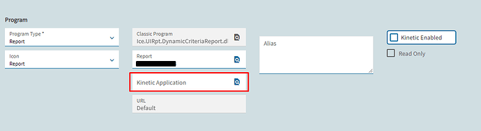

Haven’t tried the zip file thing but as far as I’ve seen this is caused by the Kinetic Application not being able to “attach” to the menu as seen in Menu Maintenance
Even if you generate a kinetic form and shove it in manually it doesn’t seem to save. Awesome!
