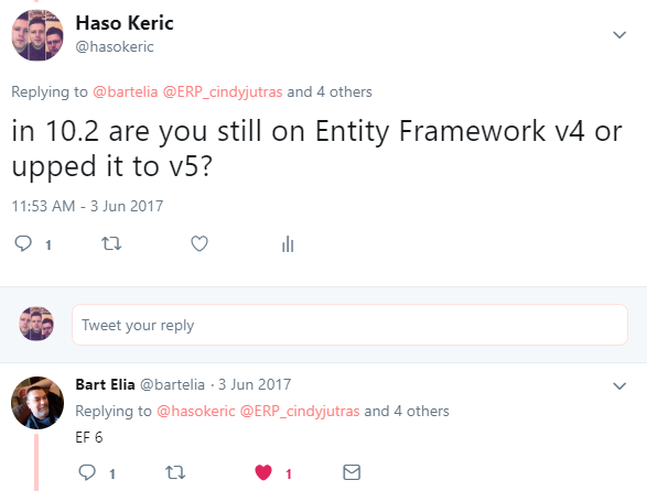

I think in Epicor 10.2 they upgraded to Entity Framework 6+ I believe the change is a EF issue and the new namespaces to use would be I believe:
System.Data.Entity.SqlServer.SqlFunctions // StringConvert, DateDiff...
System.Data.Entity.DbFunctions // For EF Functions like AddDays or TruncateTime
