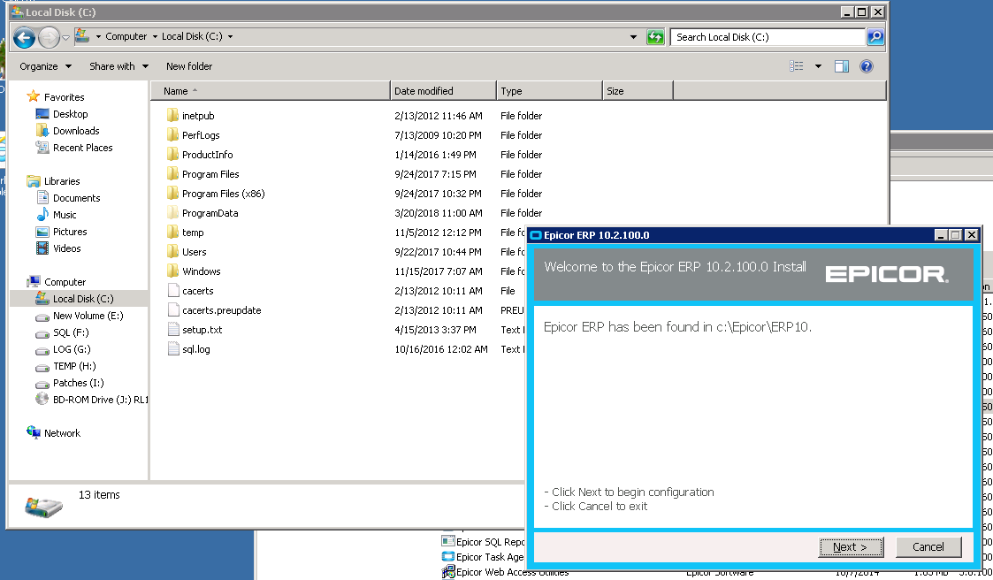

How can I change the location 10.2 installs on? It wants to install on my C: drive, but I’d like to move it over to E: where the rest is installed. The file path is grayed out and it appears to be selecting the location because “C:\Epicor\ERP10” was found, but that’s not a valid path…
Nevermind. I wasn’t paying attention the first time I installed it and let it default to the C: drive.
I went to Programs and Features to uninstall the release, but it did not remove the registry entry.
Got it fixed.
Where is the registry location?
Ah, answered my own question: HKEY_LOCAL_MACHINE\SOFTWARE\Epicor Software\ERP10.2
