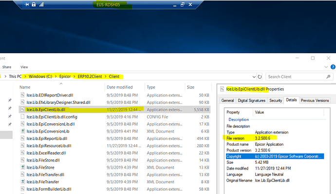

I notice that the Ice.Lib.EpiClientLib.dll on the client RDS box is version 3.2.500.6, not 3.1.600. I don’t know why the 10.2.500 programs are trying to run the older version. I’m wondering if there is a conversion or uplift step that we missed.
We have a 10.2.500.6 Sandbox and it doesn’t have these problems.
