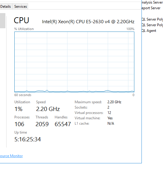

@ERPSysAdmin so I have 2 sockets @ 6 cores each. I am good. Just verified I have Std edition.

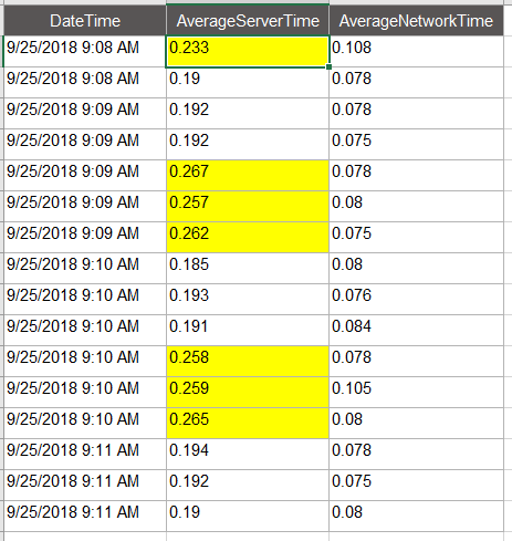

We are virtual on VMWare 6.5, one server running SQL and one AppServer, both on a NetApp SSD shelf. I am getting well within the spec for the PDT tool. In the screen shot you can see what I mean by the X86 Vs X64 bit versions of PDT. The X64 I highlighted in yellow.

Yes, as long as your VM is setup with 4 or less sockets and 24 or less total vProcessors for SQL standard edition, you should be good. I can’t say whether any other configuration would work better for you, (such as 4 sockets with 3vPs each) but your setup looks like it follows those requirements!
If you have more than 4 you can configure the SQL instance to only use certain CPU’s in the the Process or Affinity settings.
