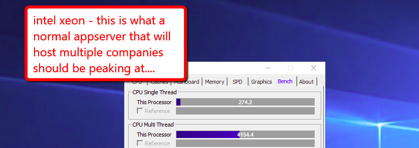

How many CPUs/Cores and possibly what Processor do you have. Can you Remote Desktop into your Hyper-V or even APP Server and run CPU-Z | Softwares | CPUID
Your Hyper-V Host should easily hit something like:
