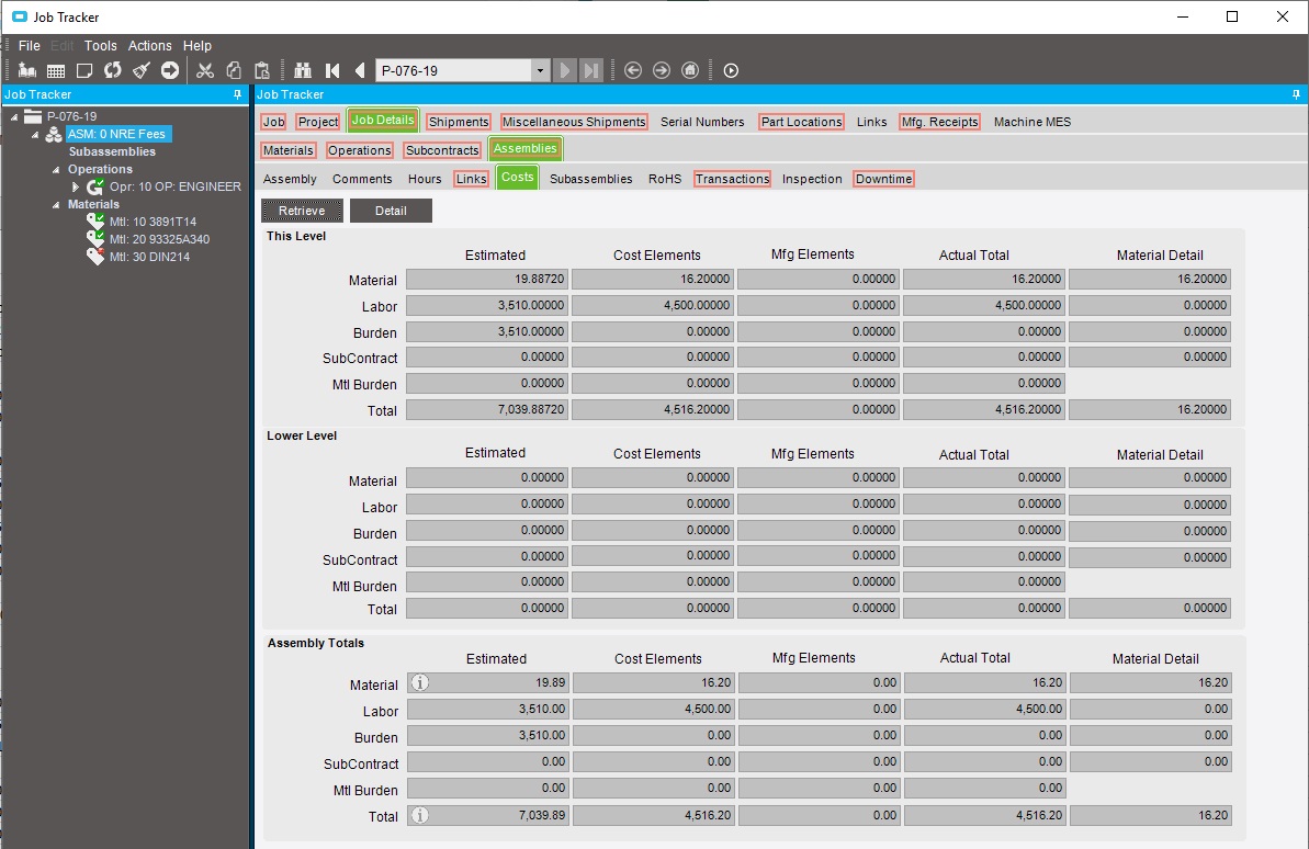

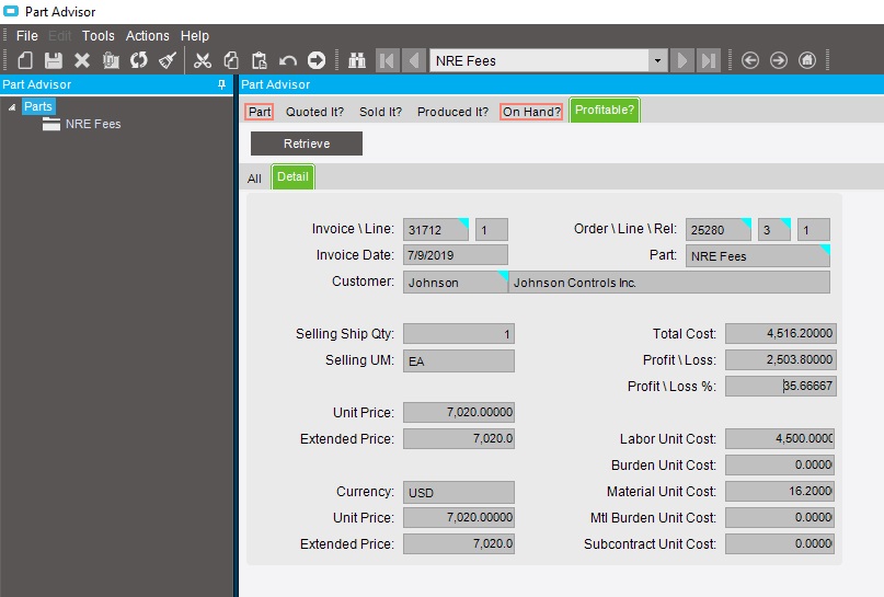

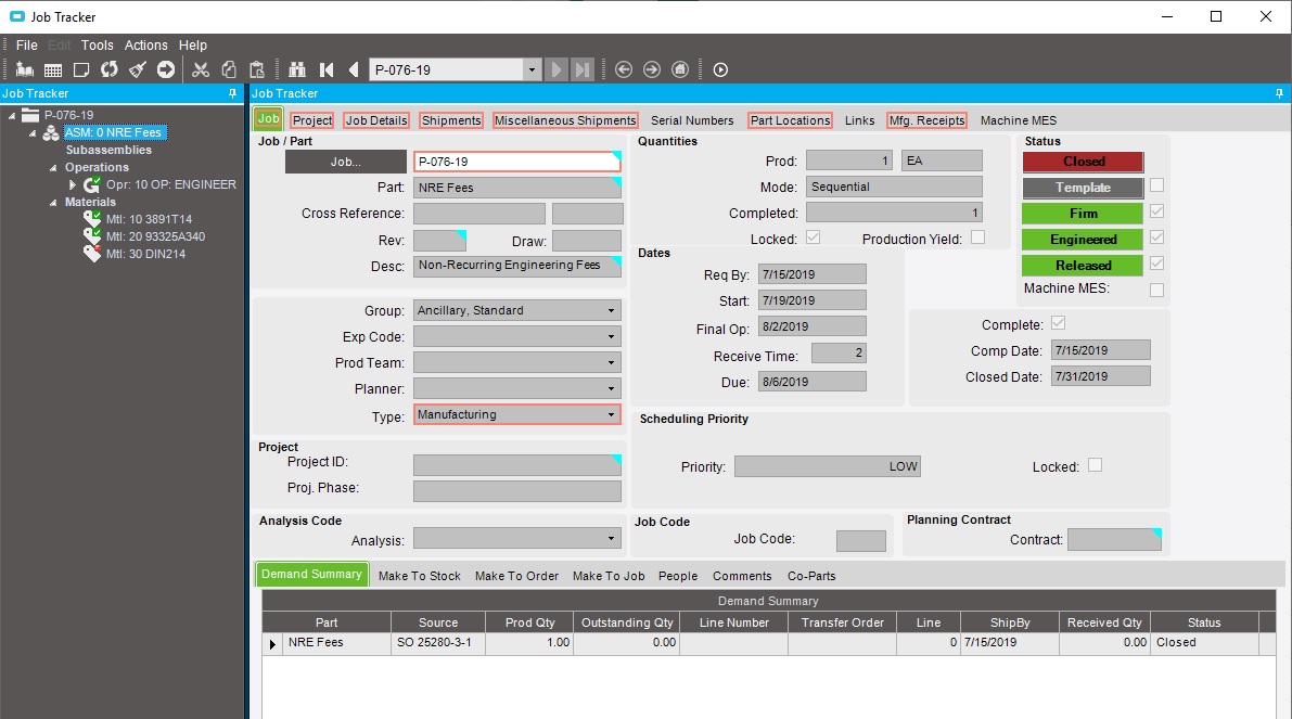

Thanks for the reply; I understand materials not being issued (that happens a lot here when we get busy; they wind up being issued after the fact and show up as WIP or a mfg variance). Our current process is to make a job for p/n XXX to inventory; the last operation is “pack”. Once the job is packed & rec’d to inventory, the job is Closed (as long as all of the costs have been pulled out of the job with the parts to inventory). The parts are pulled against a S.O. and shipped. I’ve attached some screenshots of a job that was made direct to a S.O. along with the Production Detail report, Part Advisor profitability results, and the Sales Gross Margin report.
Our head of finance hounds my boss (and he hounds me) every time the report runs and a 100% profit shows up; and I don’t have a good answer. Please let me know if anything looks off with the attachments.

The job you show is make direct or ship from job. I am pretty sure that that does not pass thru inventory and does not update average costs. What does the average cost show on the cost tab of part tracker?
OK, so this report is coming from where? The stock Sales Gross Margin report or from a BAQ spreadsheet?
Your Profitability on the NRE (Non-Recurring Engineering) Fee for invoice 31712 is 35% which should show on the standard report.
BTW you are showing labor but no Burden (which in my opinion would be incorrect). The engineering department should have some burden rate as there is overhead. It was in the estimate, but the actual has none. This tells me that the labor
was reported in a different Resource Group than was set up, there is an error in the setup of the Resource Group the work was performed under or there was an error in the labor entry.
The Job Tracker shows a material not issued (DN214). If it was used, those costs will not be in the job costs.
As Calvin said, if you do a Manufacturing (Job) Receipt to inventory, all of those costs move to inventory. The costs mix with any existing inventory if a costing method of average is used. Thus the costs are from the existing inventory.
The demand appears to be a make to order. Had the item been shipped direct from the job instead of inventory, the actual costs would have been used on the invoice. Thus the SGA would be what the actual costs were.
