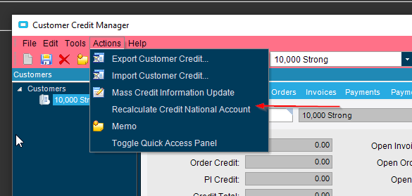

This is an on-going issue with our 10.2.300 system. The event log receives a rolling 100,000+ log entries every day due to Epicor attempting to process customer credit deferred transactions for a single customer.
Epicor support was useless on this issue, given they couldn’t even identify the initial cause or attempt to try after I identified it for them.
We have a customer with a local SOTotal of an extreme negative number: -99999999568343. We can’t calculate credit against this customer, it provides the same error (out of range exception, due to the extreme negative). The error log is generated by the deferred table attempting transactions against this one out of range number.
It holds up all deferred transactions and kills the calculation process. Anyone know the exact calculation used to determine this value?
