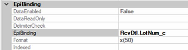

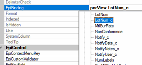

So, I feel like I lost my best friend or maybe I am just lazy. :frowning: In 10.2.400 when I added a UD field to RcvDtl it would also show up in the porView in Inspection Receiving. This was a wonderful thing. If I needed to show the data or update the field, I just bound it to the input and it was done. Now in 11.1.200.10 they show in the RcvDtl view in Receipt Entry, but not in the related view porView.

Receipt Entry 10
Receipt Entry 11
Inspection Processing 10
Inspection Processing 11 – No UD fields

Support told me that the RcvDtl UD fields got moved to RcvDltAttrValueSet the attributes table after 10.2.700. It was reported as a problem and dev responded with that was the go forward place for the porView.
I added them there did a regen and they do show on the form. I think rather than messing with the one to many of an attribute table I will just get the data from RcvDtl.
